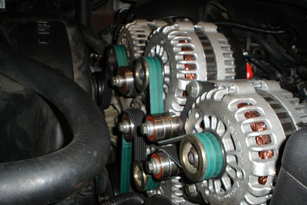

Actually, let me buddy up on this post with an update on my truck:
For those that haven't seen any of my previous posts, I've been fighting with my quad alt setup for a while now, 1 130a alternator and 3 380.
I'm adding ~ 2 more 50' spools of 1/0, a few more batteries once I get a rack welded, and I changed the setup of the pulleys. Basically the belt was slipping a bit and if I went over 2500rpms it would break the tensioner. I haven't tested this new one over 2500, but I will next time I'm driving near home. Appears to be working MUCH better.
I broke 4 belt tensioners in 2 weeks (ac delco) so I bought a Gates one from Napa and it was built totally different. It's been holding up pretty good for 3 weeks now. I also bought a heavy duty belt from napa- 081265hd which is an 8 groove so I had to chop it down :-). Pics:
Original install:
After moving the idler bearings a dozen times
You can see those two bearings are very close at one point lol
Belt seems to be working great so far (old one shredded UP!)
A/C delco tensioner, where I put #1 and 2 is where it was breaking. The small metal piece was breaking at 2, the gap at 1 is where it starts working its way apart, eventually just seperating into two pieces.
Gates tensioner, built totally different. MUCH better part.

Well I can say I can put 8 to 10,000 watts to the subs and keep above 14.4 volts up front. Still adding in more runs of wire to get it to the amps (reason why I still haven't turned it up all the way).
I did 153.6 at the dash sealed tl at 32hz with the CD player skipping and 155.6 in the kick
. I'm hoping for 155 or 156 sealed at 32hz when I'm done. And it peaks at 42hz :-)
