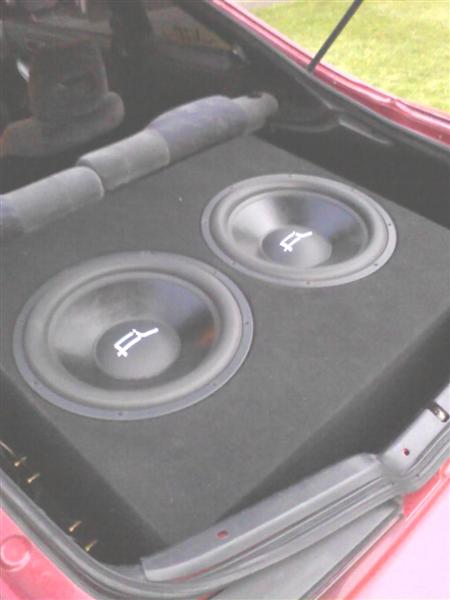

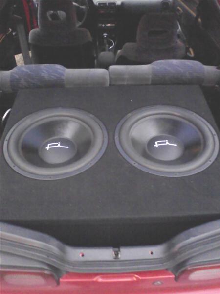

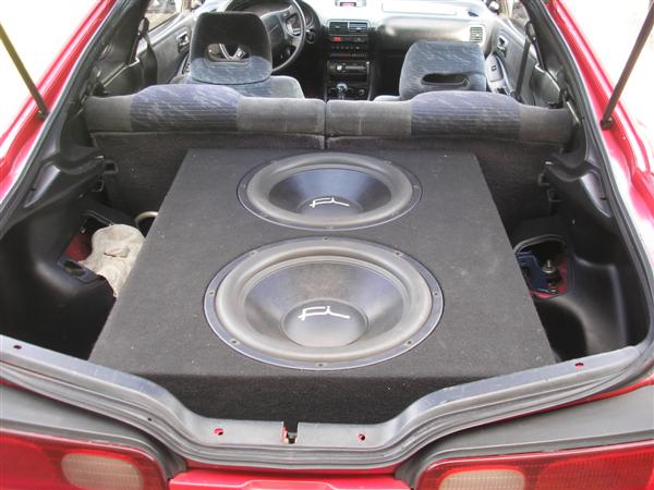

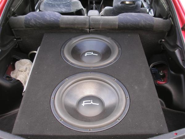

Jaymes heres my 2 setups that I have had in my Teg.
15" Q's 5.1cuft net sealed.
33"x27"x14" were the dimensions. When I had the box running vertical I was unable to push the rear seats into locking position. So I turned them sideways and the enclosure sits up on the wheel wells just a tad but not too much.

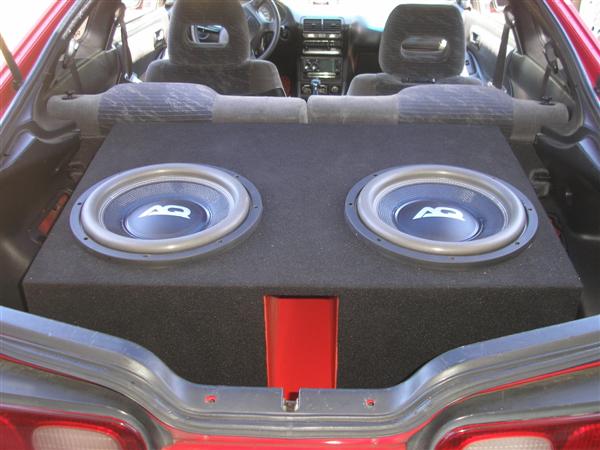

Currently running this. 2 12" AQ SDC2.5's 3.6cuft net tuned to 35Hz. This enclosure is 33"x23"14".

lol. Nah, just showing him what it looked like in my teg and what the box dimensions were.
A pic is worth 1000 posts!!
Post Number: 17948
Still looks amazing. Nice box!

The red port looks awesome.

i was thinkin about runnin aq's ive been planning on them for a long time. how do they sound? and yes its a hatchback..lol
Username: Crayola0
Portage, Wisconsin
Post Number: 2474
and i see that the port faces back. how does that sound? i was thinkin port up and subs up with the port just behind the seats and the subs as close the rear as possible so i can utilize the hatch as much as possible
Username: Naledge503
Portland, Or
Post Number: 4146
It sounds good to me. Especially the upper sub region. It lacks in the low end compared to the Q's but that is to be expected. I think that a larger enclosure would help out on the low end though. 3.6cuft net is really cutting it with these drivers.

The AQ enclosure is 33"Wx23"Dx14"H
The amp is mounted between the seat and the enclosure and yes right now I have all stock electrical, but I do have the big 3 done.
The power wire I ran through the firewall on the passenger side. You should be able to find the hole in the firewall pretty easily.

I am running an AQ2200d at 1 ohm to them. No lights dimming that I noticed....but I rarely drive at night.
