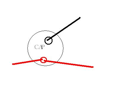

New member Username: TpharohBradford, Ontario Canada Post Number: 9 Registered: Dec-06 | I just purchased a 6 farad cap for my car. I bought it for future plans. But in the meantime id like to install it. The guide/install pages it came wich are a japenese to english translation looks like jiberish to me. and im not new in the audio install world. Just cap's. All id like to know is how to charge and hook it up to my car. It should be simple right, but i dont understand the Positive input / output terminals and the neg input / output terminals. In the diagram it comes with to install it, doesent make sence to me. Anyone? If u need to know its a Soundstream sx6 6 farad. And it comes with im guessing a little light to charge it. |
Silver Member Username: WaresgaragestereoFort Valley, GA Post Number: 315 Registered: Mar-08 | A Cap! omg. anyway here what i was told. no very many ppl on E like caps tho. |
