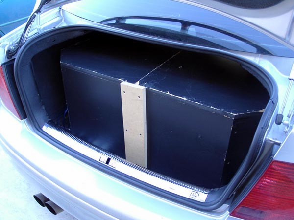

I just tried to put my new box in my trunk but i cant seem to get it to fit, what should i do?? I was thinking of cutting it into 2 pieces and putting it together in the trunk.

trial and error is the key. i basically put my box together with just a few screws first to see if it fit, and cut as necessary if needed. i honestly don't know how i got the last box in lol, because i sure couldn't get it out (through the trunk that is). i had to remove my passenger seat...

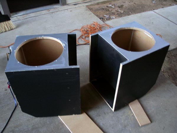

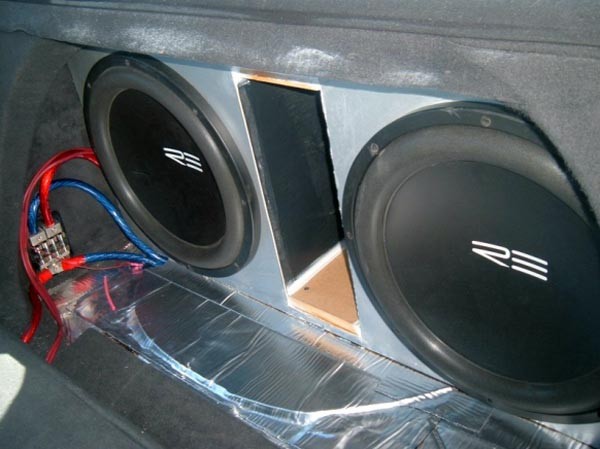

i had to install my box through the rear seat.. took it completely out.. cut the top of the trunk metal and bent it up..
cut the box in half down the port in the middle.. pieced it together inside the trunk then folded the trunk metal back down and dynamatted it so you woulda never known :-)
but that was two 15"s .. not quite sure why your having issues fitting one?
but yeah, try through the rear seat opening first before you cut/rebuild

nice work man. clean install
