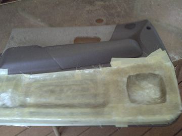

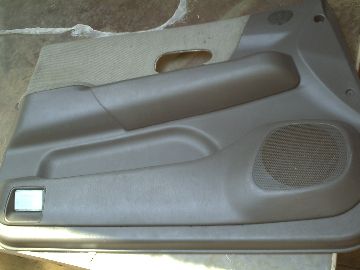

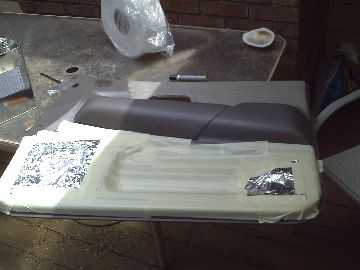

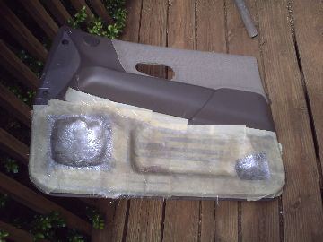

First heres the door. the bottom panel was removed.
Resin
Mat
Door taped off. I made a recess to add more airspace for the M6(large foil part).
First layer of mat.
There a blue tint to this because i believe i didnt use enough hardener on this door. There's about 2 1/2 layers here.

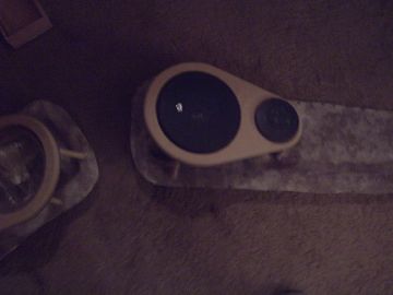

Driver's side

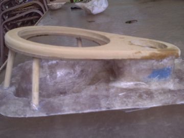

Speaker ring mounted
Speakers dropped in.
Test Wrapped

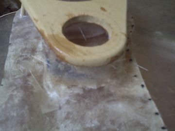

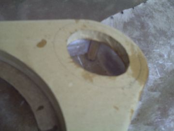

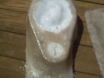

I thought of this idea while Working on them. Both the M6 and HD-3" have higher than normal Xmaxes for thier size. So i wanted to keep them from effecting each other's performance. So i glassed the area around the HD-3" to seal it off from the M6
Another pic of HD-3" sealed off
And another
Inside shot

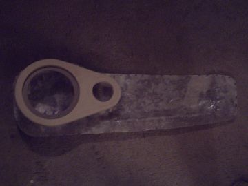

Wrapped and soaked in resin. With this you want a material that is absorbant but not too absorbant and streches. the soaked fleece isn't the strength of the pod the mat is. The fleece just provides a sturdy place to lay more mat.
Saoked

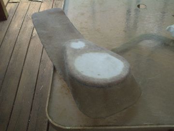

First layer of mat
Another shot
And another

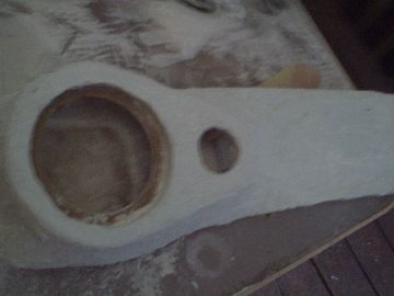

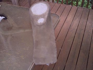

There's 1 1/2 to 2 layers on the outside of the pods

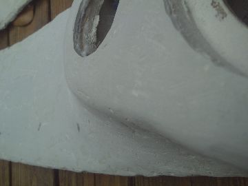

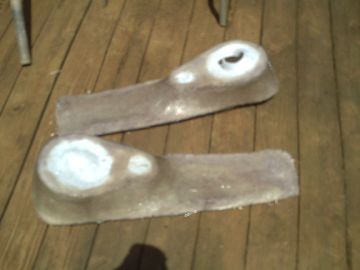

Rage filler layed down and sanded
another
and another
one more
Uno mas

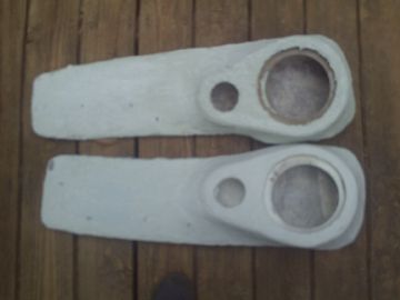

And this is where we stand today. I still have alot of sanding and touching up to do and still have to wrap it, but we're getting there.

chill out with the body filler phil lol. Take it easy. Don't use more hardener than you need too. Looks good. Hope you finish them soon.
Username: Philly306
James Carrol is the re...
Post Number: 1225
Registered: Apr-07
Yea berny as soon as i layed down the filler i knew i put way too much, but it hardened before i could do anything about it. The second pod has alot less on it but still has too much.
I actually put less hardener than what was recomended since it didn't stay in a gel state for very long.
I'll just have to sand........ALOT. lol
