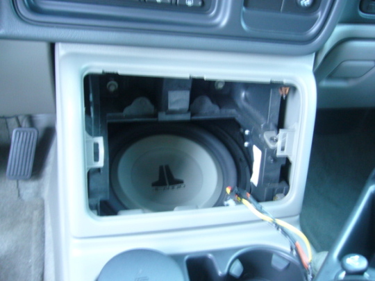

New member Username: JamesdoeTustin, CA USA Post Number: 4 Registered: Jul-08 | Here's my current setup: ![]() |
Silver Member Username: Hittin1Lake Charles, La. United States Post Number: 775 Registered: May-07 | nice starting point for sure! |
Platinum Member Username: WingmanaliveA pic is worth 1000 posts!! Post Number: 17521 Registered: Jun-06 | Wow. Can't say I've seen a sub buried behind the dash b4. How did that work for you? |
