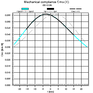

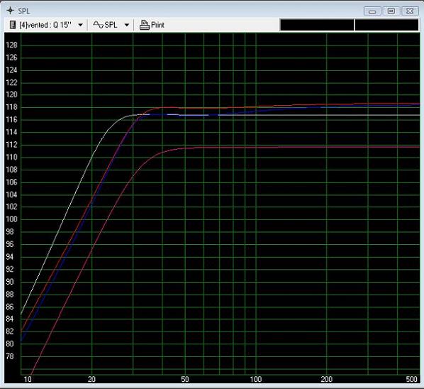

Silver Member Username: DenimSoundSolutionsAudio.com, MD USA Post Number: 759 Registered: Nov-06 | That is a shame it was not a good install. It has received glowing unbiased reviews from the guys at DIYMA (and they are bigger SQ heads that the majority of the audio net), in addition to Kippel testing to support those reviews. Ported box sizes for the Icon, are on the larger end of the spectrum. For an idea through a WinISD for an Icon 15 and Kippel results for an Icon 12, showing it is a real SQ sub, just look how flat the response curves are, and the late roll off. In the WinISD graph in their optimal boxes the colors go like so: Blue - Fi Q 15 in 3ft^3 @ 30Hz Red - RE SE 15 in 3.5ft^3 @ 30Hz White- SSA Icon 15 in 5.75ft^3 @ 25Hz Kippel Results: Reviews: http://www.diymobileaudio.com/forum/showthread.php?t=38293 http://www.diymobileaudio.com/forum/showthread.php?t=33953 http://www.diymobileaudio.com/forum/showthread.php?t=16972 |

Silver Member Username: GibsonguyStorrs, CT USA Post Number: 259 Registered: May-08 | but that graph of the icon compared to the q and the se is a bit misleading in my opinion. someone who didn't read the box specs you posted would infer the Icon was a better low end driver than the q or the se. but after looking at the large differences in box specs. it's evident you were going for better low end response with the icon than with the other drivers. all 3 of them had very flat response curves, so i wouldnt say one is deff. a much better sounding sub than another based on the graph. They all seem to do pretty well in that regard. I was wondering though, what amp was used with each of the drivers? Im just wondering how much power each driver saw in the test, since that's a big factor as well as far as output is concerned. |
Gold Member Username: 04redmach1Es DEALER, GA USA Post Number: 2157 Registered: Mar-06 | I want to see the Fi Q in that 5.75 box that the Icon is in, and the Icon in the same 3 cube box that the Q is in. That Q box seems a little small if you ask me, and it would give a better comparison Kevin |

Silver Member Username: DenimSoundSolutionsAudio.com, MD USA Post Number: 761 Registered: Nov-06 | Seeing that someone else made that WinISD chart, and posted it on CA.com, it is not trying to make the driver look better. Link since people would prefer to say I was trying to fix the results. http://www.caraudio.com/forum/showpost.php?p=4829124&postcount=37 Not to mention I had said the Icon prefers larger than average (exact reason we canceled the 18" model), in addition it is WinISD hence the rough "idea", not set in stone. For the most part, that WinISD graph shows that the Fi and the RE cater a little better to the masses with a stronger peak in a more in cabin type environment. |
Silver Member Username: GibsonguyStorrs, CT USA Post Number: 267 Registered: May-08 | Quote from the person who posted the graph. "Unfortunately, the Icon is beast in that diagram because it is in it's optimal enclosure according to WinISD" and a note to readers...all of these graphs have just been made with winisd, no actual subwoofer testing was done here. it's all theoretical testing done with a program that uses driver/box specifications to try to show real world results. just something that should be considered when looking at these graphs. |
Silver Member Username: DenimSoundSolutionsAudio.com, MD USA Post Number: 762 Registered: Nov-06 | Exactly, BBP6, Leap, WinISD, and so on are only guides to give a starting point or idea. ![]() |
