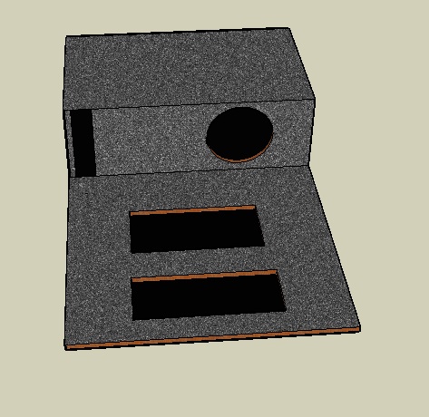

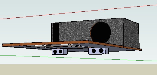

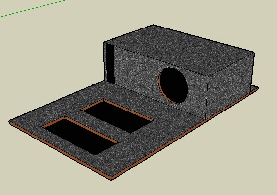

Gold Member Username: JakeyplaysbassSt. Louis, MO / ASU Post Number: 2938 Registered: Jul-05 | Heres what im thinking... -The black rectangle "holes" will be covered with plexi and have the amps mounted to the car under. -The right fans will push air while the left will pull. -The frame (3/4mdf) will be in 2 pieces so i can pull one up to get to the amps. The second piece will be under the box so everything is the same height. |
Gold Member Username: JakeyplaysbassSt. Louis, MO / ASU Post Number: 2941 Registered: Jul-05 | This is going to be impossible to explain without a drawing... but... when wiring a set of fans should i... Distro block to relay (87), HU to relay (86), ground to relay (87), fans to relay (30)...this is on the tyco relay (old bosch). |
Diamond Member Username: BestmankindPost Number: 21493 Registered: Oct-05 | good idea jake. |
Platinum Member Username: James1115Use a simple... Post Number: 10692 Registered: Dec-04 | you got it covered man! |
