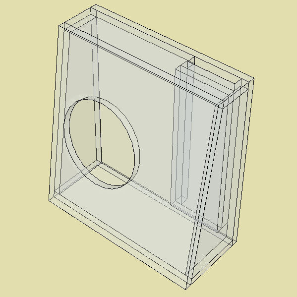

Gold Member Username: Mr_keboAlbertville, Al USA Post Number: 1494 Registered: Nov-04 | mr. cabinetry. My max dimensions behind the seat area is 9"bottom depth 5"top depth 18.25" Length and 25" Tall. Would you be able to work me something up for a single SQ10. Im wanting to keep this system low power and just add a little more low end range to my music. Nothing crazy its just my work truck. |
Silver Member Username: Phil_salisburyPost Number: 740 Registered: Sep-06 | Mr Kebo, I'll work something up, sealed or porte and what kind of port, round, slot or flared? |
Gold Member Username: Mr_keboAlbertville, Al USA Post Number: 1495 Registered: Nov-04 | Really wanting to see if we can working something slot ported up. |
Silver Member Username: Phil_salisburyPost Number: 744 Registered: Sep-06 | Mr Kebo, Here ya go: 18.25" w x 20" h x 5" TD x 8 1/8" BD - .75 cf Slot Port - 1 x 5 x 17 1/4" @ 32Hz ![]() |
Gold Member Username: Mr_keboAlbertville, Al USA Post Number: 1496 Registered: Nov-04 | Awesome Thanks for the help |
