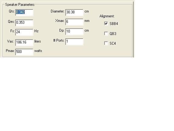

This is what i found to be the best on REs site... tell me what you think.
Username: Van_man
Boston South, MA
Post Number: 4074
try to dl this program. I hear that re aint to accurate.
get the vented one. third down, and compare it to the re one specs.

well, this is what i need.
Username: Van_man
Boston South, MA
Post Number: 4077
The following Theile Small speaker parameters are user defined inputs. These values should be inputted by user preference.
Alignment: Choose desired alignment
SBB4: Good response, Large enclosure, Low tuning frequency
QB3: Slightly degraded response, Small enclosure, Lower F3
SC4: Degraded response, Large enclosure, Low tuning frequency
NOTES:
IMPORTANT: MAKE SURE THE UNITS MATCH (e.g. Vas is in liters not cubic feet). Pmax, Diameter, and Xmax are not required for box calculation. They are used to determine the power response curve. Vb, Fb, F3, and Lp will still be valid. Vented designs require tuning. Vented Designer should give a good approximation of box parameters.
Calculated Parameters
The following speaker/box parameters are calculated:
Vb - Volume of box (one to be built) in liters
Fb - Box resonance in Hz
F3 - Half power frequency in Hz
Lp - Length of port in cm
NOTES:
F3 is the most important parameter. The lower the F3 the lower the bass. A F3 below 50 Hz should be suitable.
Vb is the volume of the box. Generally, the lower the bass the bigger the box.
For Box Calculator instructions go here.
