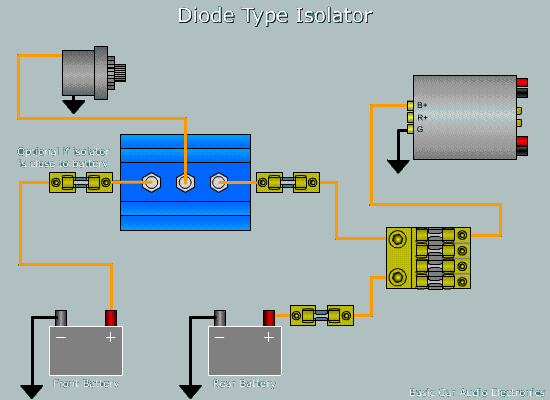

Username: Nd4spd18
Northwest PA
Post Number: 7717
The problem with the relay is you have to make sure you never engage it with the engine off after playing that system for hours, or you can wind up with 2 dead batteries.
I would use an isolator for that reason.
Username: Imi4tth3w
San Antonio, Texas USA
Post Number: 181
could someone draw up a diagram or something for that? i'm really interested to see how that could be done.
Username: Nd4spd18
Northwest PA
Post Number: 7741
Credit: bcae1.com
