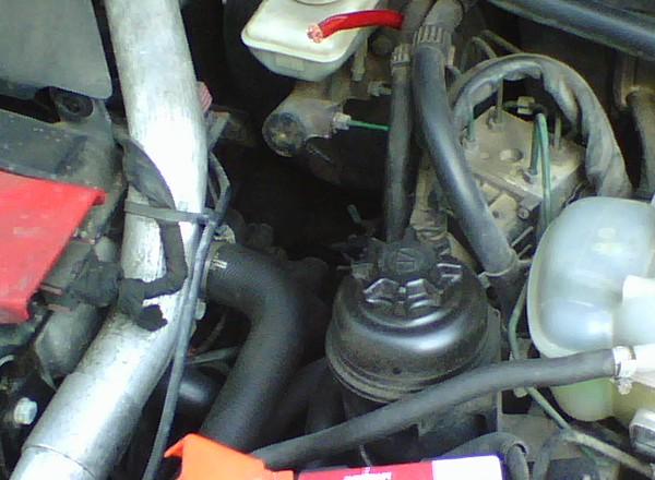

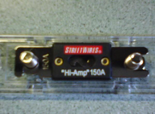

Silver Member Username: AudiosaabPotomac, MD Post Number: 187 Registered: Nov-07 | Hey, so i just got my new anl fuse holder in the mail today. I am looking to install it under the hood and have all the parts.... problem is ive never installed this before and my last install under the hood was not done by me.... using these pictures and your knowledge would you mind telling me a step by step as to how to install such as disconnect battery if i have to etc.... Thanks ![]() |

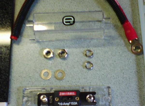

Silver Member Username: GibsonguyStorrs, CT USA Post Number: 171 Registered: May-08 | disconnect the negative terminal on the battery. make sure you move it far enough away that it cant get close to the battery. it's too blurry to see, but then connect the positive wire that you see in your engine to the anl fuse. you have to loosen those screw on the anl fuse, push the stripped wire in, then tighten them. then do the same thing with the red wire you have with the ring terminal on it. then connect the right terminal to your battery. then connect the negative wire back to your battery. one problem i see is with the power wire in your engine bay. it should reach closer to your battery. make sure the fuse is within a foot of your battery. any longer than that and things can get a little dangerous. also, secure the fuse and wire to some safe place in the engine. make sure it's away from all moving parts. if you have any questions let me know. but there should be plenty of pictures online that you can look at. |
Silver Member Username: AudiosaabPotomac, MD Post Number: 188 Registered: Nov-07 | i guess my question would be how to connect the wire to the pos on the battery then...sorry its so blurry, best i could do using a cellphone camera.........in other words how do i connect the ring terminal to the pos bat? |
Silver Member Username: AudiosaabPotomac, MD Post Number: 189 Registered: Nov-07 | and it is close enough, i measured to a ft on the dot![]() |
Silver Member Username: GibsonguyStorrs, CT USA Post Number: 173 Registered: May-08 | this is what it will look like. just doing a better job of routing the wire than this guy did. doesn't look real safe to me, but you get the idea of how it should all fit together. https://www.ecoustics.com/electronics/forum/car-audio/260732.jpg |
Silver Member Username: GibsonguyStorrs, CT USA Post Number: 174 Registered: May-08 | i bought a battery terminal from knukonceptz to connect my power wire to the battery. That's the best way of doing it. |

Gold Member Username: Nd4spd18Northwest PA Post Number: 7707 Registered: Jul-06 | Gibson's instructions are right on. As for your question, " how do i connect the ring terminal to the pos bat? " If your battery has top posts you need one of these: http://www.partstore.com/Part/Phoenix%20Gold%20International%20Inc/Phoenix%20Gol d/TMC-24G.aspx?s=froogle Then you would need to put ring terminals on the stock wires if they don't have it already. If it has side terminals you need one of these: http://www.autotoys.com/x/product.php?productid=2243 |

Silver Member Username: AudiosaabPotomac, MD Post Number: 191 Registered: Nov-07 | lol, sorry to scare you Rob....i know what im doing with electricity (going for electrical engineering currently at URI) but i was unsure as to how to connect to the battery initially because i didnt realize im supposed to use the clamed teminal end and screw it in..... took me about 2 seconds to get this all done once i realized it so thank you all for your help i am now bumping with 0 gauge wire XD |
