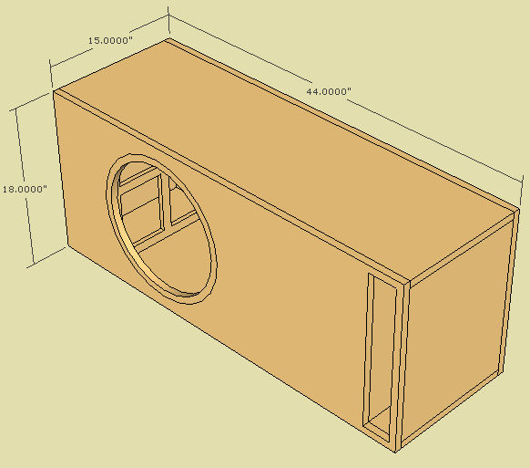

Q, ok, here ya go. I did two designs since I saw the comment askin Scott about the sub up, port back.
RD Alpha 15 4.5cf 32Hz
44 x 18 x 15 / Slot Port - 3 x 16.5 x 26.25 / .75 mdf
Carpet - Charcoal Grey or Black
Terminal Cups
Reg Cost -$ 185.00
Your Cost $ 160.00 - Shipping $ 70.00
Total $ 230.00
44 x 16 x 17 / Slot Port - 3.5 x 14.5 x 26.5 / .75 mdf
Terminal Cups
Reg Cost -$ 185.00
Total $ 230.00
Given the size and weight, it will have to be shipped to a commercial/business addressed location.
However, I can build them with UL MDF, that would save ya $ 10.00 on the shipping and they could be shipped to your home addressed location.

As to the question of " a difference is bass /spl " given the direction of sub/port you'll get varying opinions as to which would be best.
I must could not honestly tell you, it one of those " try it and see things ".
What I could do is design the enclosure as such that you could " change " the port firing direction by basically uncoupling the side end of the enclosure that has a slot port.
However, such a design would cost more than what I quoted and for the little gain in performance it may not even be worth the added expense.
As for the shipping thing, as long as I got a name, company, address, I can ship it.
