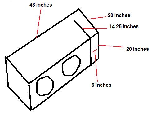

Diamond Member Username: BestmankindPost Number: 21153 Registered: Oct-05 | ok with the dimensions you gave me, you can make a box this size. 8.865 cuft with 102.5 sq inches of port area. it will be tuned to around 32hz. since we have a lot of volume to work with, your box is able to achieve the desired tuning frequency without the L bend. no L bend = less turbulance. ![]() you car will be so fricking loud and clean i can't wait to hear it. 2 re xxx 15s with 2 rd audio 1750.1. man just thinking about it is giving me a woody. DAYAM!!! ![]() ![]() ![]() |

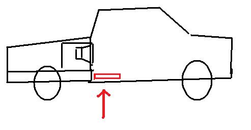

Diamond Member Username: BestmankindPost Number: 21155 Registered: Oct-05 | also later we can make a sick looking amp rack and place it like in the pic below. ![]() |

Gold Member Username: Loc_outSOCAL2 RE 15 XXX Post Number: 2187 Registered: Feb-05 | wow thank you chad. i was thinking of the amp rack behind the seats? but your idea works too. What the diff with port in the middle or one port? |
Diamond Member Username: BestmankindPost Number: 21157 Registered: Oct-05 | not sure about difference but i was thinking of putting the port on the driver side. we can do middle too if you like. its just if we do the port along side one of the walls, its easier to add length to it if you want it lower tuned. |

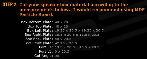

Diamond Member Username: BestmankindPost Number: 21158 Registered: Oct-05 | ok after sean's comment, i got to thinking. i think we are getting too greedy with the volume of the box. so i decided it should be a tad smaller. it comes out to 8 cuft. with the driver displacement it will be a bit smaller than that. i think it would be better like this. as you can see, i shaved off 2 inches from the height. ![]() |
Gold Member Username: Loc_outSOCAL2 RE 15 XXX Post Number: 2188 Registered: Feb-05 | Chad does this look right?![]() |
Diamond Member Username: BestmankindPost Number: 21162 Registered: Oct-05 | ![]() |

Gold Member Username: Loc_outSOCAL2 RE 15 XXX Post Number: 2189 Registered: Feb-05 | No Phil i had asked Chad but that was like two months ago. he replied yesterday saying he would have it ready for today. Thank you Phil. Okay going to get everything cut by this weekend. |
Diamond Member Username: BestmankindPost Number: 21165 Registered: Oct-05 | when you get it cut, remember the thickness of the mdf is .75 inch. |

Gold Member Username: FrkkevinTeam DLSSuperNatural... Post Number: 5195 Registered: Nov-05 | nice drawings ![]() |
