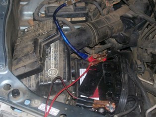

Bronze Member Username: SlivdoggSt.ignace, Mi United states Post Number: 12 Registered: Jun-08 | will someone show me there amp power cable connected to their battery i wanna see pics? |
Bronze Member Username: SlivdoggSt.ignace, Mi United states Post Number: 21 Registered: Jun-08 | i need some pics because the ring terminal on my battery is really skinny so im wondering if i can even hook up an amp to it |
Silver Member Username: WaresgaragestereoFort Valley, GA Post Number: 194 Registered: Mar-08 | no idea what ur talking about but here ![]() |
Silver Member Username: WaresgaragestereoFort Valley, GA Post Number: 195 Registered: Mar-08 | no idea what ur talking about but here |
Bronze Member Username: SlivdoggSt.ignace, Mi United states Post Number: 27 Registered: Jun-08 | ill get some pics of my battery on friday and then u can tell me if i can hook a amp to it and how |
Silver Member Username: WaresgaragestereoFort Valley, GA Post Number: 196 Registered: Mar-08 | no idea what ur talking about but here ![]() |
