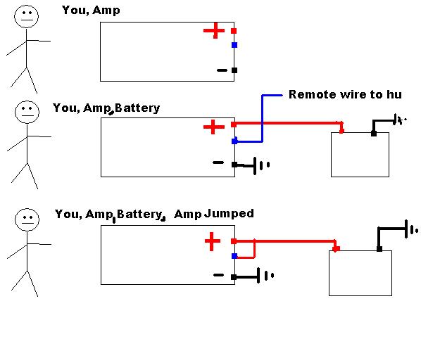

Username: Van_man
Boston South, MA
Post Number: 3984
what ohm load is the subs wired to? and does that amp support it? Try a jumper from the amps positive to the amps rem terminal. Does it power on? This only works if theres 12 volt on the power wire at the amp, and the ground is good at the amp.

Username: Audiosaab
Potomac, MD
Post Number: 145
Registered: Nov-07
the subs are wired to one ohm which the hifonics bxi 1606d can supoort fully and i have 2 4ohm alpine r's......
im not sure i understand what u mean marc with a jumper per say...can u put it in easier terms for me im not good w. the special naming....
and my remote wire actually broke about a week ago but i had some wire to extend it into the rem slot earlier this week...so it should be fine
Username: Hittin1
Lake Charles, La. United States
Post Number: 415
"im not sure i understand what u mean marc with a jumper per say...can u put it in easier terms for me im not good w. the special naming.... "
run a short wire from the 12+ to the remote terminal(on amp) while the power wire in plugged into the 12+ terminal. See if it powers amp...
Username: Hittin1
Post Number: 416
"and my remote wire actually broke about a week ago but i had some wire to extend it into the rem slot earlier this week...so it should be fine"
all the more reason to check it 1st!

Username: Van_man
Boston South, MA
Post Number: 3985
Username: James1115
Use a simple...
Post Number: 10616
Registered: Dec-04
hahahahahaha nice skills man:-)
Username: Audiosaab
Potomac, MD
Post Number: 147
Registered: Nov-07
well, lets see, i tryed that and it instantly blew the fuse on my car...so i had to use my spare fuse to get the stereo itself running.... but alas i am still, after rewiring, checking my ground rem and 12v wires and my wiring to the sub.....stuck with the blue leds on the top being on (mind you in a dimmer fashion, like they no longer glow brightly) and no power or protect light
hmm what to do, what to do any other suggjestions?
nice picture though lol
