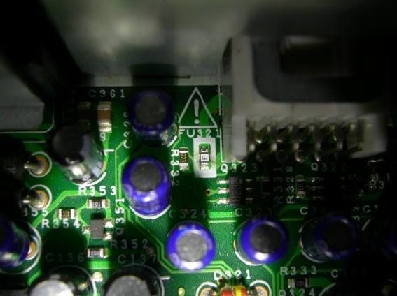

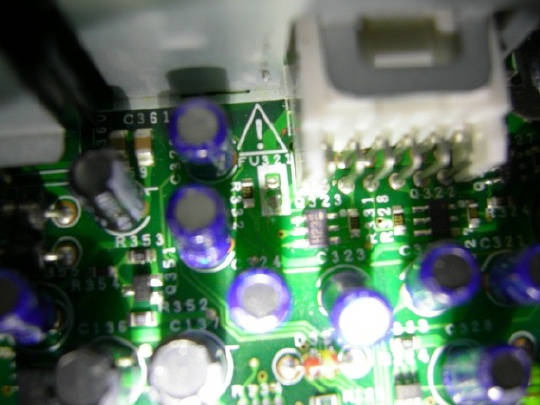

Username: Safe_cracker
Chicago, IL US
Post Number: 4558
Micro fuse right next to RCA junction, notice the white highlight and little plume of blackness on the board.
Gently heat and remove with soldering iron.
Tin a single strand of wire and solder in its place of the fuse.
If this is above and beyond some of you people you can send it to me (for a fee) and I can do it for you, fast and ship it back out via any means you are willing to pay. I'll even test it. Polo..
