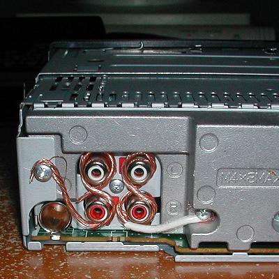

did you do this?

usually pioneer has that whine problem so you need to ground the RCA's just like the picture juliob showed.
Username: Drant19
DUB-C, TX
Post Number: 922
Registered: Aug-07
yep pioneers are infamous for trying to ground thru the RCAs.

Holy Cow, Juliob. That's nuts! I'm going out to try it. I'll be back to let you know.
Jonathon: MP3 plays clean through the amp. It's definitely the Pioneer, regardless of which or how you run the RCA's. If Juliob's idea works, I'll be laughing in disbelief all day tomorrow

Juliob, dude, where do I send the check? Crystal Clear. Not a single hint of alternator whine. Problem: doing this you lose stereo separation. I think even if you skipped the figure 8 wrap and wrapped them individually you might lose the sepration. Any ideas??

"Problem: doing this you lose stereo separation. I think even if you skipped the figure 8 wrap and wrapped them individually you might lose the sepration. Any ideas??"
Please correct me if I'm wrong, But you should still have stereo separation. The signal is on the center terminal of the RCAs. The outer shield of RCAs connect to ground. Ground is only reference for the signal and carries no audio.

Yep, you're right. I tested it after I left the post. I also found out that the figure 8 wrap is not necessary. It did not matter which pre-out I grounded, the result was the same: perfection. It stinks though that such a nice receiver would have this problem.
