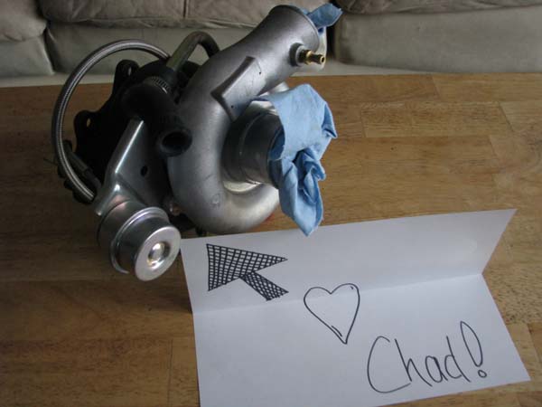

how do i find the compression of my car?
Username: Big_edge_head
Milwaukee, Wisconsin
Post Number: 2046
lol. what is that supposed to mean?
Username: 04redmach1
Lagrange, GA USA
Post Number: 1847
LOL!! You must be a weird looking fella with injector(s) lol. I bet you get all the women :-)

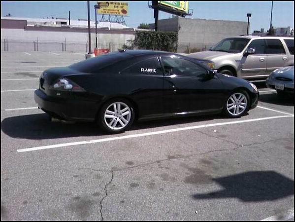

Diamond Member
Los Angeles, CA USA
Post Number: 20679
rob i don't got the 19inch rims anymore. i have my stock 17s back on there now. when i get new rims next month, it will be 18s so i can have more tire.
