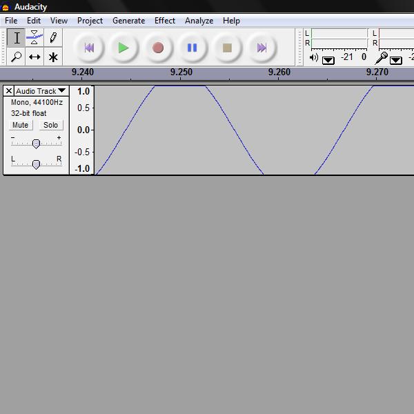

Silver Member Username: DuckaShelby Township, MI United States Post Number: 269 Registered: Jan-08 | From what I know/ have heard, clipping is when the bass goes past what the sub can handle and the sub just kind of playes a flat line at the peak of what it can handle. The best way I can describe what it sounds like is just bad... since bass is a sine wave it "clips" the peak of the wave off. From my experience it is prett difficult to tell unless it is clipping badly(it will sound very Sh1tty) This is what clipping looks like. The best way(IMO) to set the gain so that it does not clip is to use a multimeter and figure out how many volts should be produced for how many watts the system produces... My friend has a website that can calculate all of this for you, but unfortunately he is not online right now. I will get the link for you as soon as I can though. Hope that this helps. p.s. clipping is bad lol, but it sounds like you already know that. |

Silver Member Username: Gh0st_31USF, FL USA Post Number: 763 Registered: May-06 | Kevin you hit it right on the nose |

Gold Member Username: BernymacCambodia Post Number: 3902 Registered: Sep-04 | Kevin ftmfw, great explaination. |

Bronze Member Username: PeakohmPost Number: 19 Registered: Apr-08 | good post kevin. in real life for me it reminds me of a "scratchy, cracking up" kind of sound. |
