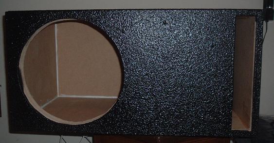

Gold Member Username: Crayola0Portage, Wisconsin Post Number: 2375 Registered: Jun-06 | what is your box covered with and how much was it |

Silver Member Username: DurskiPost Number: 416 Registered: Nov-06 | Pike, since this is a 15" I want that filter off... I think, I wanna wang on the lows. Jay, Rhino liner - $102 after tax, kinda expensive, but I got lazy and didn't wanna carpet / put the liner on myself. Looks good but it doesn't cover up some of the flaws like I hoped it would, but that's my fault |

Platinum Member Username: WingmanaliveA pic is worth 1000 posts!! Post Number: 16244 Registered: Jun-06 | Nice lining. Looks rough. Anyone ever have/had any problems with air leakage around the rim due to the thick lining? Looks like it would hinder a tight seal. I know a rubber gasket fixes this but how many use one? Just curious. |

Gold Member Username: Mj23dynastyAlpine ida-x001/2 dd 2..., Woodlawn Por... USA Post Number: 1957 Registered: Oct-07 | love the rhino liner lol |
Silver Member Username: O0airjordan120oPost Number: 397 Registered: Sep-07 | whats the spray on the outside? |
Gold Member Username: Safe_crackerChicago, IL US Post Number: 4424 Registered: Jan-06 | Actually Paul, as long as it isn't to uneven around the sub area, it seals like a rubber @ss gasket! I brush mine on instead of roll, comes out smoother but protects all the same. Polo. |
Platinum Member Username: WingmanaliveA pic is worth 1000 posts!! Post Number: 16249 Registered: Jun-06 | Good enough. It's just from the looks of it, it looks like there would be some kinda air gap. The stuff looks similar to popcorn ceiling texture. That's why I asked. ![]() |

Platinum Member Username: Rovin1 15 = 149.1DBsTrinidad & T... Post Number: 13623 Registered: Jul-05 | interesting finish - should have sprayed inside d port with black sray paint to match & complete the look ......![]() |
Silver Member Username: DurskiPost Number: 418 Registered: Nov-06 | I'll paint the inside of the port black when I have some time this weekend, lots of people told me not to get that part sprayed with the liner. This pic was a little odd, it's not that uneven around the rim. The Q came with a gasket, I was a little worried about the seal not being that great as well but I tried shining a light at all kinds of angles and nothing was getting through so I think that's sufficient. It's hard as hell to get this stuff off once it's on, I tried, other wise there wouldn't be excess aroung the speaker hole. I know I should set the gain with a test tone and DMM, and that it's not a volume control. But since I dont have a DMM and I wanted to hear something to make sure chauncey didn't rip me off (he didn't) I just set it at 1/2. 90% was an exageration. Box is 3.4 cubes @ between 31hz and 30hz, I forgot the exact tuning, changed box dimentions a little from the original design. Started to rain, pix tomorrow |
