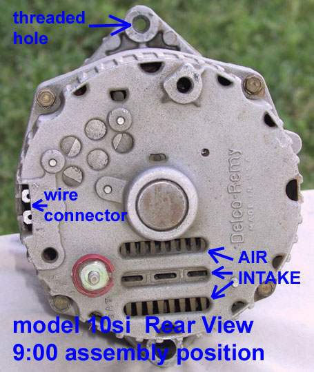

Username: Adddisorder
Palm Beach, Florida
Post Number: 6226
Sorry polo i got ya on this one
quote:
A point about the "AIR INTAKE," which is seen in photos of the alternators viewed from the rear, above. Clearly the author has written "air intake," and not air exit or air exhaust. The fan at the front of these alternators is an exhaust fan. The fan draws air in through the opening at the back of the alternator, where the air will pass through cooling fins at the rectifier heat sink. And the air will be drawn through the stationary "stator windings," where the air will also have a cooling effect. As usual with moving air through passages, the same fan efficiency will suck more air than the fan could blow through. That's why the fan at the front is an exhaust fan.

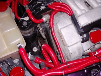

Username: Basebalz13
Moneta, Va Usa
Post Number: 460
Registered: Aug-07
thats the spot where i want to mount it, the stock spot is on the bottom of the engine, and a complete pain in the azz to take on and off every month

Ummm Matt not everything you read is right! I just checked my Bosch 300 A alt which uses dual internal fans and it sucks from the front (pulley end) and blows out the back. There may be alts that would suck through the back but that would be inefficient because the rectifyer is the hottest part on the alt, due to the conversion. Also in a rear driven vehicle where the engine faces front to back, engine cooling fans would be blowing towards the engine and yes the alt totally negating the purpose for the alt fan sucking through the back. BTW I just started my car and checked to be sure and maybe delcos are the way you think, maybe this is why Bosch makes better alts but if I was to design one, would be just like Bosch's ! Polo...

polo help =]

Ok, here is what I found. Alts with external fans actually pull air from the rear, these are the ones with the fan by the pulley, very inneficient design if you ask me. the internal fan alt are the ones with no fan at the pulley and has a lot of holes in the case. Internal fan alts use two fans, the front one pulls air from the front and side blowing over the rotor and windings. The second fan sucks air from the side like the front and blows over the rectifyer and pulls the air from the first fan out the rear, much more efficient. Why do you need to relocate your alt? BTW what engine/year is it? Polo..

ah ok polo, reason i said that is that because i just got done rebuilding an alt for a 5.7 GM volvo and it pulled from the back to the pulley side this was in a boat though.
and yes i though about how it didnt make since for in a car but after finding that info i posted made me rethink. i did some more research and those are older alts pre 80s it seems and thanks for clearing that up it had me wondering tonight.
