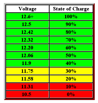

Letting any battery go "dead" is a bad thing in regards to its' lifespan. Typically you shouldn't run any 12v batt below 50% DOC, unless it's a deep cycle battery.
Mind you that is at rest voltage.
