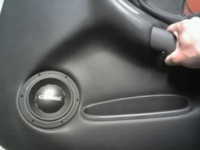

Well this seems to be getting more difficult as it goes. I can just take my sawzall and cut a great big hole in the door then just fit in a crappy set of comps but I think I am gonna take the difficult route lOl. Now the door panel will contain the mid and a seal, the door intself will contain a fiberglass cup for the back end of the mid to protrude into. When the door panel is put back in the seal on the panel will mate with the enclosure on the door effectively sealing the mid.1/2" Felt pad will be the actual gasket and antiresonance agent, so the panel doesn't create noise. Here is what the front will look like, biggest problem will that I won't be able to use the included grills, gonna have to come up with something custom, of course... :-O Polo..

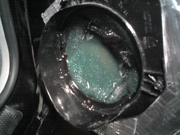

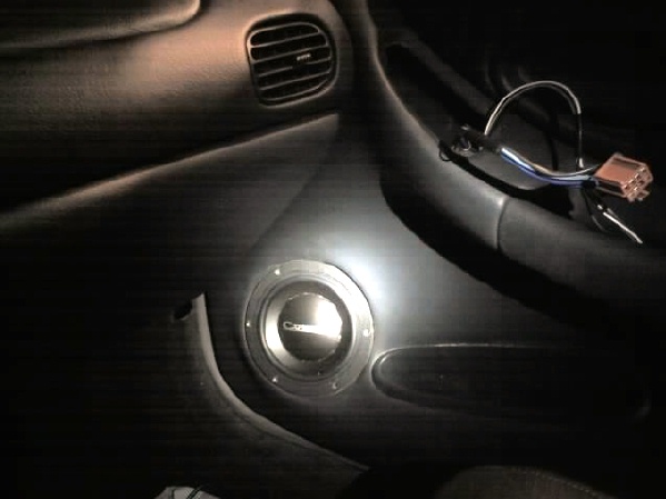

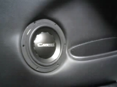

Been a while but was all coming back, influenced by you glassy fools lOl ! I cheated, I used infrared lamp to ensure proper curing in 50 deg weather, works awesome. The enclosure is the pocket in the door (green fleece, poor blanky) the other half in the recess in the door panel when mated they create a chamber, easily removed if you need to remove panel again. If you look at the first pic that is the way the stock are installed, inside of angled piece, I put the new ones on top, aimed right to the listener. I was sooo high from the fumes, woooohoooo. That peal and stick sh!t is great, especially when heated with a torch... Polo.
