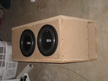

Silver Member Username: KaerfplSpencerport, NY USA Post Number: 876 Registered: Jun-06 | Quick pics before carpeting ![]() ![]() |

Silver Member Username: B3n07Louisville, Ky USA Post Number: 832 Registered: Jul-07 | how many cuft is that box |
Silver Member Username: KaerfplSpencerport, NY USA Post Number: 877 Registered: Jun-06 | 2.2 Cu Ft 38Hz |

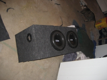

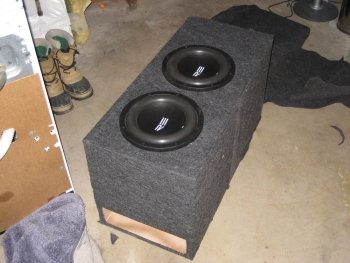

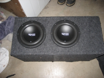

Silver Member Username: KaerfplSpencerport, NY USA Post Number: 879 Registered: Jun-06 | Final Result: ![]() ![]() ![]() ![]() ![]() |
Silver Member Username: KaerfplSpencerport, NY USA Post Number: 880 Registered: Jun-06 | Still have some trimming to do, but it looks cool for now. |
Bronze Member Username: WaresgaragestereoFort Valley, GA Post Number: 79 Registered: Mar-08 | yes, very well done |
Platinum Member Username: WingmanaliveA pic is worth 1000 posts!! Post Number: 15861 Registered: Jun-06 | Looks good to me.![]() |
Gold Member Username: Big_edge_headMilwaukee, Wisconsin MY SUBS GET ... Post Number: 1894 Registered: Mar-07 | Nice man. I'm gonna have to try that out this summer for sure. |
Silver Member Username: KaerfplSpencerport, NY USA Post Number: 882 Registered: Jun-06 | Tips that U can give you guys: 1. Do not make your cuts along the edge of the box. 2. You will get adhesive on you, so have something to clean your hands. 3. Make sure surface of carpet and wood are clean before applying. 4. When ever cutting with the razor, always cut slightly on an angle (about 30 degrees). 5. Work fast. You have about 1 min to get everything in place. 6. Spray both the wood and carpet with adhesive for a maximum connection. |
