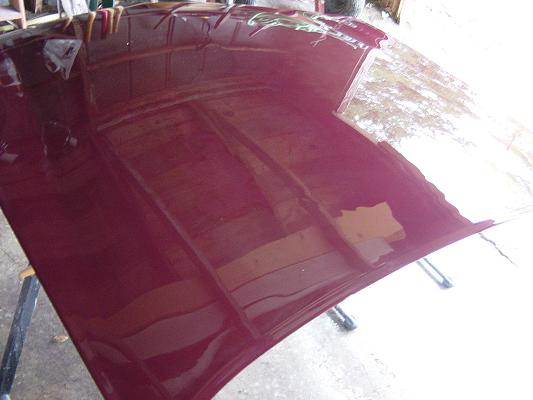

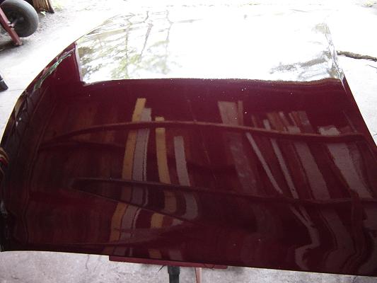

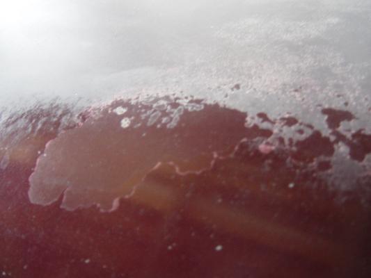

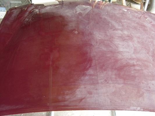

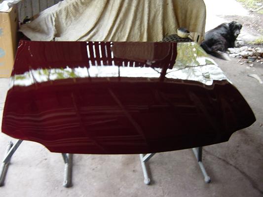

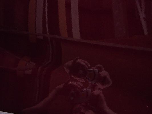

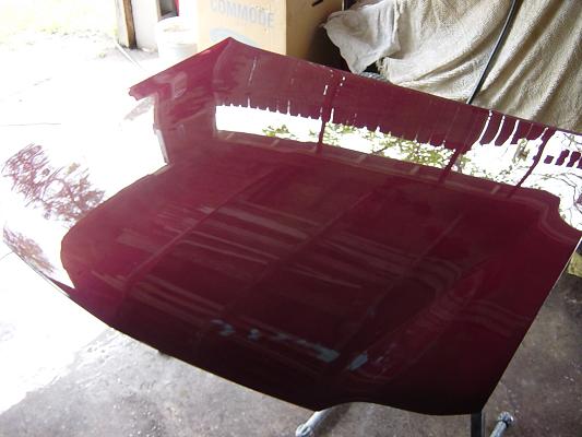

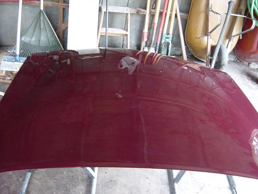

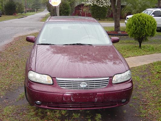

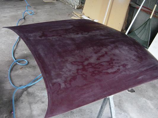

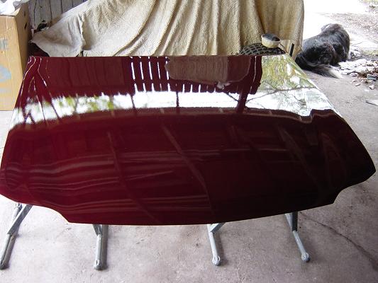

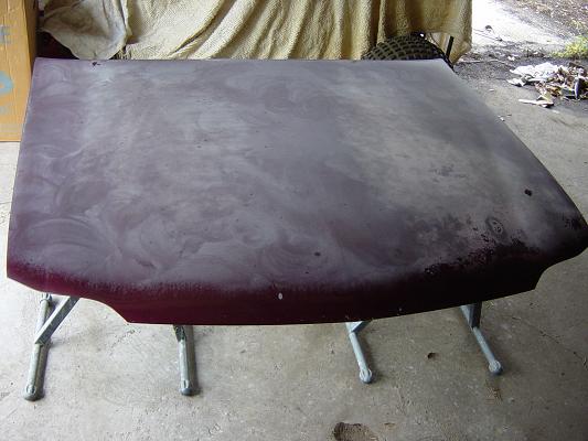

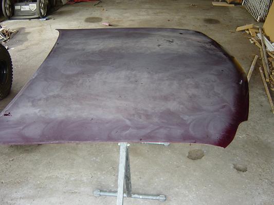

Gold Member Username: TejcurrentPost Number: 1245 Registered: Apr-07 | So my wifes hood has been getting worse and worse on her 98 malibu. The clear has been flaking until recently almost the whole thing just turned grey. I decided to spend the money on paint for the hood and make it my 2nd paint project. I'll most likely be taking the bad panels entirely off the car so i don't have to worry about overspray- and it's easier to me to take out a few bolts and take my time than spray awkward-like. Last thing my wife said to me about it: "I don't want to spend a lot of money on it since I plan on selling it soon, and no matter how the job turns out it will be better than it is". Like I said- 2nd time using a paint sprayer, so while it could've been better I'm getting practice. Her fenders and bumper will probably be next. On to pics: Originally it looked like this- you can see the sliver at the tip that's the burgundy color it's suppose to be: ![]() ![]() ![]() Started wetsanding with some 400grit ![]() finished with the 400 ![]() Started with the 600 ![]() ![]() And drying before paint. Basically I talked to a couple paint guys and they said not to sandblast or bother priming since the old paint and primer were still good, just the clear was flaking. I just got down to thin paint/primer layer: ![]() And immediately after spraying- it smoothed over quite a bit after this, but you can see the orange peeling: ![]() Then the G*DAMN trash and gnats got in it: ![]() Just drying ![]() ![]() Today I touched it up with a some 2000 grit, but I couldn't only very very slightly because of the metallic flakes and pearlization. Then buffed and waxed. I need to buy some buffing pads, but it turned out OK. Much better than before anyway. I'll get some better pics when it's not raining, but here's the finished product. ![]() ![]() Any tips on doing a better job next time much appreciated, but practice makes perfect I guess. It still looks soooo much better, even if only a little above a Maaco job. |
Platinum Member Username: Big_edge_headMilwaukee, Wisconsin MY SUBS GET ... Post Number: 1838 Registered: Mar-07 | Looks great.![]() |
Silver Member Username: Drant19DUB-C, TX Post Number: 656 Registered: Aug-07 | that looks D@MN good troy!!! mad props |
Platinum Member Username: Philly306New quote coming soon, North carolina Post Number: 1053 Registered: Apr-07 | another great job by troy. It looks flawless to me. i can't tell a difference from the pic. good job man. |
Platinum Member Username: The_image_dynamicSan Diego, California Post Number: 3665 Registered: Dec-06 | x4. The color match is perfect too. Nice job. |

Platinum Member Username: TejcurrentPost Number: 1247 Registered: Apr-07 | ^naw, nothing I couldn't say I wouldn't just be repeating from someone else on a paint/fiberglass forum![]() Thanks guys! I'm sure she'll really appreciate it. If you look at the first pic you see all those white swirl marks- that was where she tried to wax the hood and couldn't even get it to wipe off it was so rough. Little tiny imperfections wont look any worse than a car that age that has a few rock dings in it- but a huge discoloration it had can really be embarassing to a young woman I guess. I know I'd be pissed ![]() |

Platinum Member Username: TejcurrentPost Number: 1248 Registered: Apr-07 | ^ I believe the hood was repainted before she bought it. I think it was in an accident before and they just didn't do that great a job on it ![]() It was a '98 btw My wife and I are the same age ![]() |
