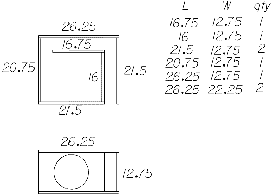

Platinum Member Username: DrivingrecklessDD 9515f, 148.2 db Mov... Post Number: 5751 Registered: Apr-06 | have you tryed editing your posts ROB? or is post whoring fun?? NOTE: it is wider then 22"s 2.5 cubes gross 34hz 50 sq inches of port.. and old design of mine that might help you ![]() |

Silver Member Username: Hittin1LakeCharles LA., La Post Number: 190 Registered: May-07 | Drivingreckless. Thanks bro but that enclosure is to small. I would like at least 5+^3 if possible... But keep that same tuning.. Thanks for showing me your old design.. Any idea's? And it has to be no mre than 22 in wide in oder to put 2 of them side by side. |
