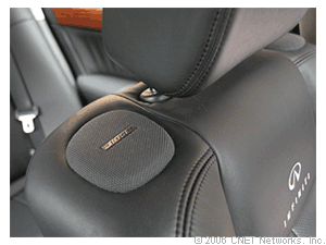

some cars actually have tweeters or speakers (not sure which) on the seat...
for example...
Username: Nd4spd18
Northwest PA
Post Number: 7155
Surround sound yeah. Thats a completely different world than 2 channel stereo.
