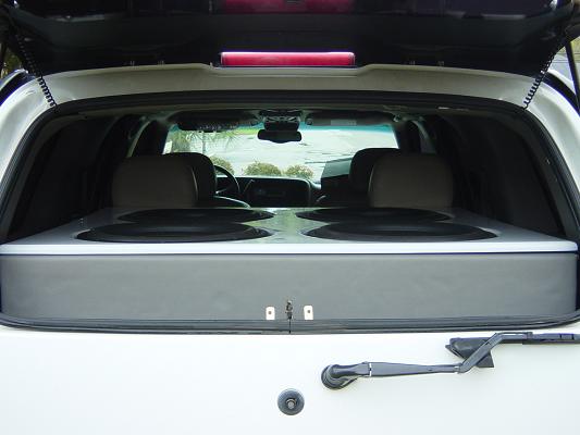

I worked on the top plate, and I'm going to call this finished for a while. It really needs buffed good- I didn't have any pads for my buffer so I just went over it by hand a little. There's a few blemishes, but it's my first attempt at spraying and they were really just from trash that got in the paint :-(
On to pics, but do you guys think black accents would look good around the equipment? I already have paint, I'd just hate to have to sand it all down just to undo it.

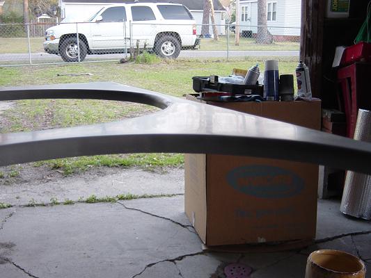

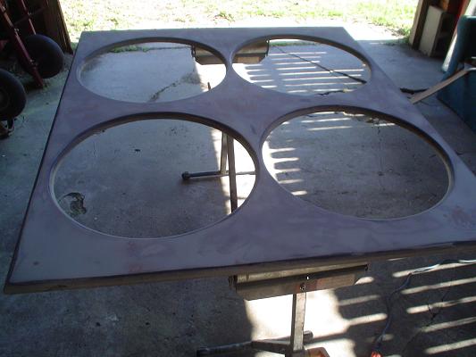

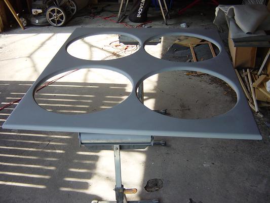

I covered the top beauty panel in fiberglass resin, then bondo so paint would stick instead of absorbing
Primed up for paint, then wetsanded with 600grit before a few coats of GM white single-stage.

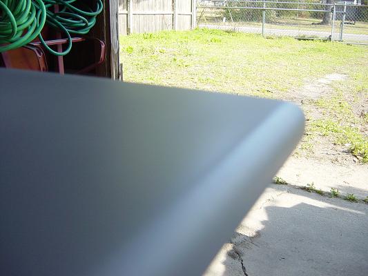

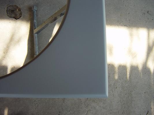

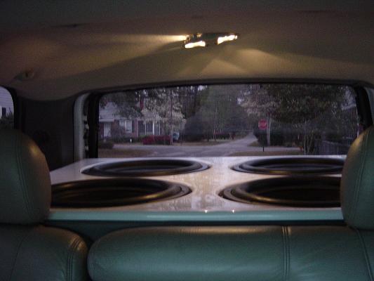

Here it is, a bit of trash got in it, and it's orangepeeled a bit- but it was my first attempt at painting with a sprayer, and I'm outdoors. :-(I sanded the blemishes out with 1000 grit, then finished it off with 2000 and cut/buffing. I didn't have pads for my buffer, so I just did it by hand for now. It could look so much better if I actually buff it right, so I will as soon as I get a chance.

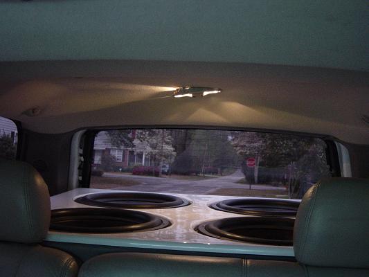

And a few inside pics. Don't mind the ghetto dome light, it falls when bass hits so I'm just leaving it.
Crap camera, but from inside the panel adds a nice touch imo. The amps will be on top of part of it, and there will be a few beauty panels vinyled to match the box and flush it in there.

Username: Bonhamd
Northern, Michigan USA
Post Number: 565
Registered: Nov-07
looks awesome troy
Username: Quirky
SA, Texas
Post Number: 216
Looks amazing. Nice job
A pic is worth 1000 posts!!
Post Number: 15501
I don't see any blemishes man. That's a nice finish! And here I was a carpet fan all this time.....
Username: Nyyfan13
15 MAG USA
Post Number: 9071
Beautiful Troy. Good job bud.
Username: Insearchofbass
Post Number: 8692
nice job Troy
Username: Andrew571
Post Number: 1668
Looks great dude.

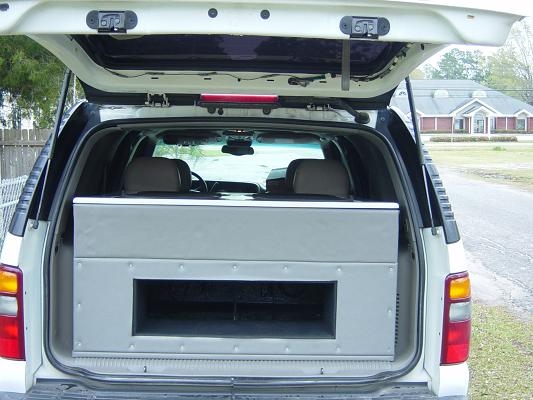

how much clearance u got between the port exit and backdoor?

Not much clearance at all andrizzle, but even with just 1 of 4 amps going on the factory alt it does over 151.5db, so I'm not too worried. With all 4 amps and alts going I should see quite a gain.

Nice how thin is the part in between the 2 18s??

Thanks again. Killerzracing, from side to side maybe 4 inches, front to back about 1-2.

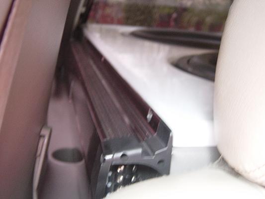

I'm putting the other 3 amps in, but mainly so I can see where to put some trim panels. I may hook up the power and grounds, but just for looks and so when I get the electrical backed up all I have to do is hook up the speakers to their designated amp.
Several reasons for the panels:
1. It looks more flush
2. It will make it just that much harder to get to the lower amps to steal them, and impossible to remove the box without removing them first (time consuming).
I'm just dryfitting things in place, but here's where the amps go on the sides. They really won't be visible. At night you can sort of see the Memphis logo glowing through the tint, but only barely.

cramped space huh? Boxes that fill up entire cargo area are b!tches to work with!

Yeah it really is :-( I picked the Memphis amps because they're the only ones that will give me the power I want and I can mount them easily. God what a pain to move though lol..
I can't say how many times I've wished I had that cargo space, but I like the bass more, and I have a trailer for a reason, right?
