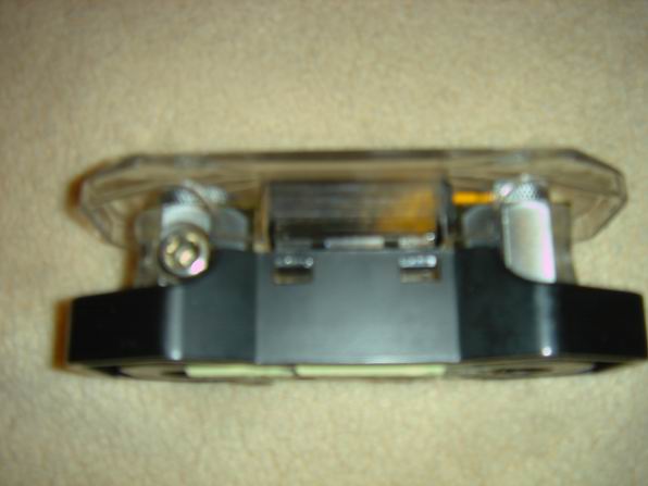

here is the fuse block i was telling you about. its yours. i know i have some distro block somewhere. i will find it over the weekend. i also have some 0 gauge terminals. they are all yours for free. lol.
pic of the fuse block. its already got a 100a anl fuse in it. its for a 4 gauge cable.

won't I need a 0ga fuse block though? lol

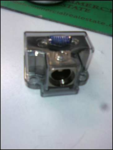

your distro has the 0ga in and dual 4ga out, right?
thanks again man!

yeah it has 1 0 gauge in to 2 out.
this is how i was telling you to do it.

would it be easier to just get a fused distro(which is what I thought you had)? I can always pick up some fuse blocks for the 4ga anyway. I can put 4ga in the comp amp right, or will I have to cut it down to size?
when you say "1 0 gauge in to 2 out" do you mean 2ga or 4ga out?
thanks for the pic, it really cleared it up.

that's what I was thinking Rovin, according to the picture the distro isn't fused, but I may be misunderstanding from him that it is.

well the distro block i have isn't a fuse distro block so that is why i put it like that. but like rovin says, getting a fuse distroblock would be better.

that fuse distro block will work good. the distro block ima send you can be used for ground. you can ground a 0 gauge somewhere to your car and then to the distro block. then your amp's ground can go to the distro block.

now in the picture, i told thieves to do it like that cause i am giving him a distro block. the distro block don't have a fuse. now he can just get a fused distro block which would be alot more convinient. i think that is what he is going to do.

Http://www.rdaudio.net...
Post Number: 19783
thieves, here's the pic of the distro block i have. you can use this for ground.
