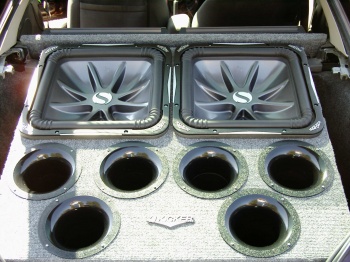

im running two L715's rite now gettin a ZX1000.1 apeice but im trying to get some more power jus for burps
Username: Basebalz13
Moneta, Va Usa
Post Number: 385
Registered: Aug-07
heres wat my car and box look like

Very nice.... should be real f'kn loud!!!

yea, me and Nick V was talkin yesterday, we came up with a 5.5 cube box net, with 2 6 inch externaly aero's, subs up, port back
