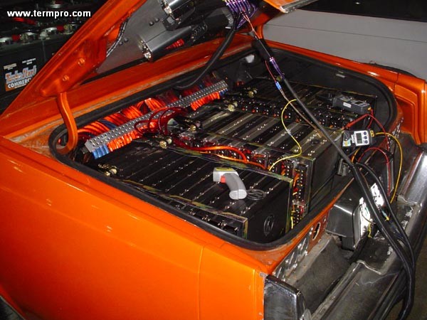

Hers a pic of dom's trunk a few years ago from finals.
