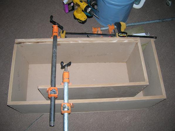

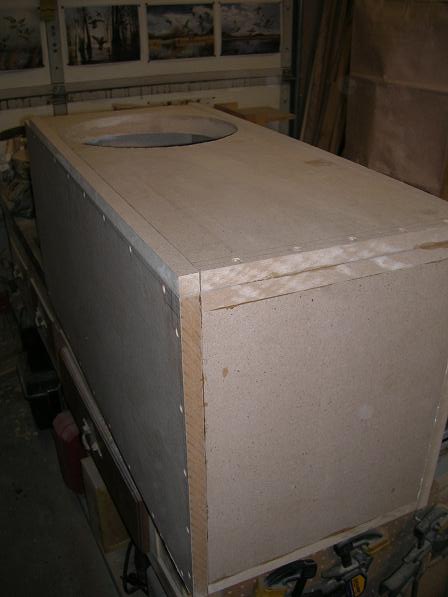

Gold Member Username: MgbcsLincoln, Nebraska Post Number: 2303 Registered: Dec-06 | Alright, I started the box for my eD 13Av.2 today. It is 2.2cuft tuned to 33hz and 43sq inches of port. I was hoping to finish but it got too late and I'm having surgery tomorrow. There is still a lot of work to be done, but it should go pretty quick. I will definitely be doing some sanding as everything didn't line up absolutely perfectly. I will also be using some filler in all the cracks and screw holes. I think I will probably be doing some sort of bedliner type of material on it after everything is smoothed out, but I am not certain. ![]() ![]() ![]() ![]() ![]() It's not perfect, but I will be making it look real good here in a few days after a little more work ![]() |

Platinum Member Username: Rovin4 10 Pioneer... Post Number: 13368 Registered: Jul-05 | on the baffle where u cut the hole for the sub u didnt leave much wood near the edge so i would advise u add some extra glue along the inside edge just to be sure but other wise it looks good ...... |
Gold Member Username: ShortysetniesRock Vegas, NC US Post Number: 2400 Registered: Mar-06 | Looks good man. Did you decide to add the extra baffle after you cut out the top and bottom? I see where you had to cut that strip to go on the bottom. Congrats |

Gold Member Username: MgbcsLincoln, Nebraska Post Number: 2314 Registered: Dec-06 | Thanks guys. No it is not my first one. It is the first with a double baffle tho and I didn't plan that quite right. Oh well, it will turn out fine after a little work. |

Gold Member Username: DrivingrecklessDD 9515f, 148.2 db Mov... Post Number: 5658 Registered: Apr-06 | i should have designed the double baffle a bit better.sorry bcs it didnt occur to me at the time that it was .75" short on the top and bottom...cant wait to here a review. |

Gold Member Username: MgbcsLincoln, Nebraska Post Number: 2317 Registered: Dec-06 | No problem Dave. I should have thought about it as well. Oh well. A review should be coming soon. I don't feel too bad after getting the wisdom teeth pulled today, so maybe I'll get some work done on it tomorrow! |
