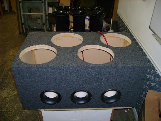

Just alil box I finished today...
Username: Southernrebel
Monroe, Louisiana 2 DD3515s, 2...
Post Number: 6138
Registered: Mar-04
Well, a guy came by and wanted 4 CVR 12's in his crown vic. The deal was that he only wanted to box in the center area of the trunk and it had to be level w/ the shelf up next to the seats. Not really enough room the way he wanted it, but he was dead set on it.
Here is how it turned out.
Close shave getting all 4 12's in.
8ga wire into the box.
Only going to be 1.6cuft per sub and 3 4" flares, but hell thats what he wanted. Shouldn't sound bad though. Tuned to 37hz on paper.
Username: Ska
Post Number: 723
looks sick dude, how much space is going to be between each sub when mounted?

Did you trim those flares down?

As far as the space between the subs, I didn't have the CVR's to test-fit.
But with Clarion SW1251's its ~1/8" between the subs.

No, those are not PSP ports.
They are Xscorpion ports. Not as wide a flare as PSP 4's but look OK. They are stock length in that box (~10"), it just worked out that the tuning was good like that.
I had 4 at the shop that we ordered to tryout, after seeing them we ordered PSP's. I actually finished this box before we got the 4 and 6" PSP's in today.
Username: Ska
Post Number: 725
dang canaan.... your a gutsy guy for cuttin them that close with no way to test, but you know what yoru doing i doubt they wont fit

Don't worry, I drew the baffle up on sketchup.
I looked on kickers sight for OD on the subs.
Username: Rovin
4 10 Pioneer...
Post Number: 13357
They are Xscorpion ports''''''
i instantly recognised em since i used these b4 - not as wide as others but works ok
box looks good .....
Post Number: 6152
Registered: Mar-04
Yea, Xscorpion makes some good stuff. Those ports are alil off, but otherwise their assesories are nice.
