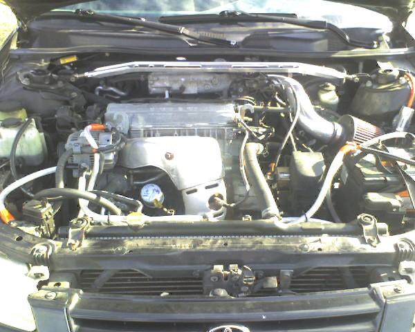

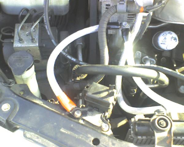

Got some 1/0 gauge wire from paul and recently did the big 3 upgrade. I noticed a dif in the voltage, before it use to sit at 14v now it sits at 14.30v. :-) so i took some pics.

nice to pick up voltage like that

Looks good.

looks good state

state what else did you need besides wire to do it?
can you make a simplified list for me and/or cheapest places to get the materials lol
id appreciate it man
Username: Nd4spd18
Northwest PA
Post Number: 6834
You need wire and terminals. And battery post adapters if your battery doesn't already have posts that ring terminals can connect to.

cool !
did mine only 2 wks ago after putting it off for about 2yrs
went from 13.8 to 14.4v at idle ! ....

Nicky, just get some 1/0 wire off paul, i got 10ft off him and got the job done. Get some 1/0 terminals, i got it from here..6 terminals all together it was like $11.95 shipped...
http://cgi.ebay.com/ws/eBayISAPI.dll?ViewItem%26%26item%3D310028474659&ssPageNam e=STRK:MERFB:IID
then you just need a knife r cutters to cut the wires/strip them. then you use a vice which is a like a clamp thing...or do it ghetto way like i did and use a hammer and put it on concrete hammered the terminals down. lol good luck. dont forget to remove negative terminal b4 doin it.
