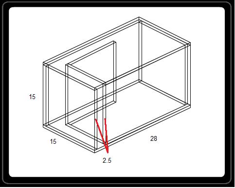

Think anyone here candraw up a box design for one 12" audioque sd 2.5? i want it tuned to 35 hz. Also, it is going into a 99 grand prix se 3.8. Thanks.

Chad...we put ours in a 2.50 cf net box tuned to 35 hz but i believe aq said 2.0 at 40 hz...I like the sound of it at 35 hz but ours was the older 2.5 12 sub...it might sound ok in a 2.0 cube net box though tuned at 35 hz
Http://www.rdaudio.net...
Post Number: 19175
how about this?
Username: Insearchofbass
Post Number: 8313
make the port wider chad like 2.5 wide
Username: Snowball123
West Allis, WI United States
Post Number: 434
yeah mines at 40 hz now, but id like to tune it lower. i think yours is still the same as mine? or different basket? idk.

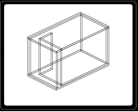

Post Number: 19178
ok how's this?
Post Number: 19179
its a bit bigger box with a bigger port area. that box just screams output and sq. lol.

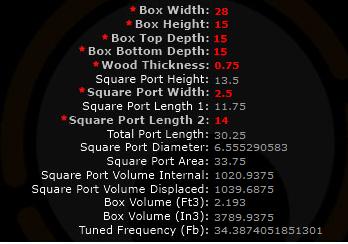

ok the only thing I see now is the tune frequency is higher than he wanted so we might as well bring it down to 35 hz...I like my bro's at 35 hz but if it was mine id tune it even lower

add 1.5 inches to the port length and youll be at a 35 hz port tune
Post Number: 19183
ok here you go. lol
Post Number: 8318
ok so there you go snow...my adjustments on the port length might have been wrong above ...end correction was throwing me off and I wasnt sure if chads program accounted for it or not in the port length
Post Number: 19186
np man. lol.

http://www.reaudio.com/speaker_box/LPort_Box_Calc.html
Username: Pbplayer05
Carroll, Iowa
Post Number: 558
is it pretty accurate
Post Number: 19192
i like to think so. unfortunately i have no way of proving it is accurate. my current box is built with that program and i love it. :-)
