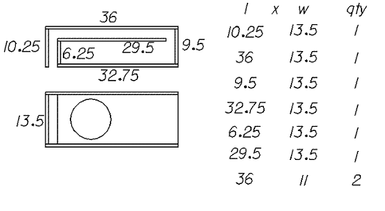

contray to what you told me in your email you really didnt have much room for this box after port, sub, and wood displacement.
11"s for depth really isnt much at all na when the cubic feet of a box gets smaller the port will be longer at lower hz...
best i could do to keep your desired tuning is
1.525 sq inches
35hz
33.25 sq inches of port area
Im not really happy with this box design either, port area is really minimal and volume is just teribble and the magnet of the sub is to close to the port...ask your friend for more room.

How much depth will you need? you can use the full 11" and you can use the full 15 height if you please.

hey drivingreckless. how do you come up with your box designs? like what program is that.

its a formula. i believe thats how driving does his as well.

i use microstation..but use math to tune the boxes....
i did use 11" depth and 15" hieght.
