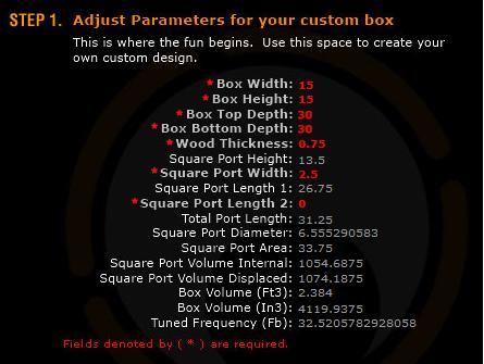

http://www.subwoofertools.com/forum/ported-box.asp?Ew=15&Eh=15&Dia=6&Xmax=18.2&V d=.071&NumW=1&Vb=2.5&Fb=32&Qts=&Vas=&Fs=&CE=0
^that site might help... Ive used it alot

thanks Kevin, I hadn't used subwoofer tools because I didn't wanna mess around with it to get a side firing port.

Http://www.rdaudio.net...
Post Number: 19068
actually make the box 32inches wides.
let me get another one for you.

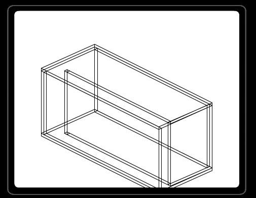

Post Number: 19069
this is better. a bit bigger. if you want to tune a bit higher, then just shorten the port a bit.
