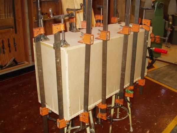

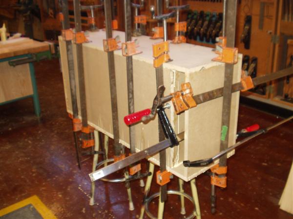

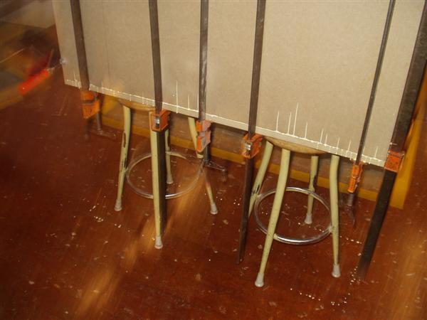

For a pair of MAW 12s. There are 2 enclosures that will stack on top of each other; one sub in each. The point of separate boxes is that it's a wall until I take the hardtop off and then one enclosure out. Then one of them sits at the height of the rear seat and gate.
Today I cut the hole for an access panel and glued some port panels along with the front panel.
These two were from this morning. Note the genius us of a marking gauge. It held the panel up while I nailed it from the bottom.
These are from this afternoon.

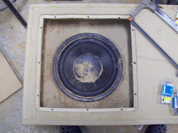

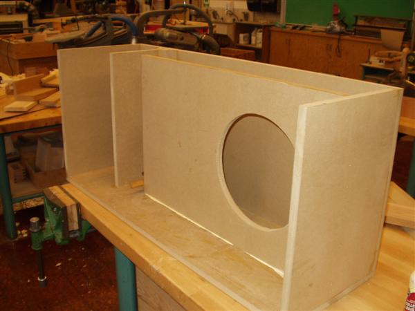

The big square cut-out is for an access panel. I'll route it a half inch and then cut a piece to 14.5x14.5 and route part of that to 14x14 to fit in there. Then it's just caulking and t-nuts to hold it in. After that, I think I'll get some bolts and make up some terminals. I should have this box completed tomorrow. Then it's on to the next one.

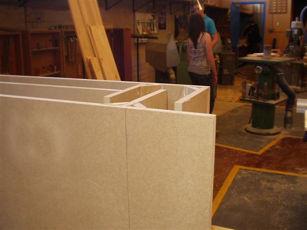

Today's Update:
I started by... *MDF dust hinders your thinking abilities*
Hmm. Well, I'll start with what I remember.
I think I did some other crap before this but:

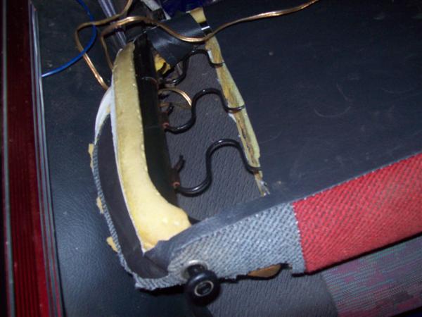

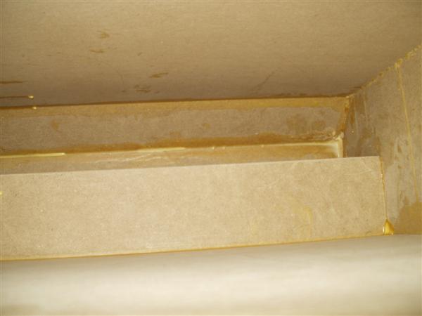

I glued the final panel on the first enclosure only to realize that I had glued a 45 in the sealed chamber. DOH! Luckily I wasn't too slow on the uptake and I popped it off and got out the chisel and mallet and maimed that 45. Got it popped out and glued the top on. Came back to do some more work after school and realized that I had forgotten a 45 in the final bend of the port. Popped that in and added some glue where it looked like it could use a bit. We had future grade 9s coming in during their orientation and my shop teacher hates people building enclosures but he likes me so I got the privilege but the people guiding the orientation kept saying that you could build enclosures. So then they all left and I started the next box. Got the ends glued to the back and then I cut the front panel's 14x14 access hole and the mounting hole for the sub. After that I cleaned all the sh!t up and took some pictures.
My shop teacher's going to pick up a spare rear seat for me because I'm going to have to take the sabre saw to the current one to prevent the port mouth from being covered. $20; not too bad.

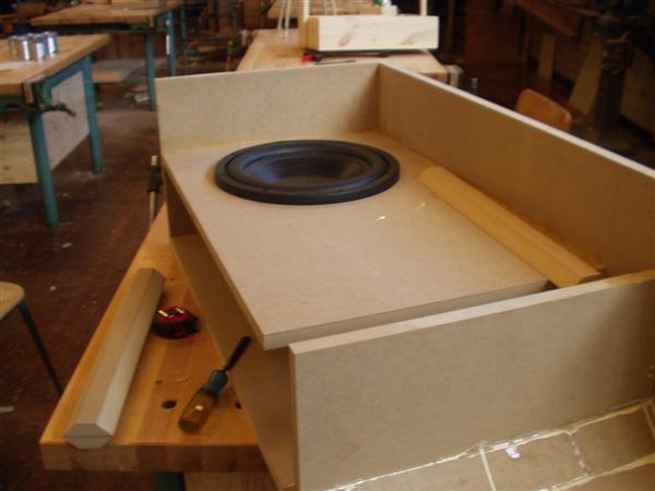

I f.cked up one of the enclosures like I had thought. Lots of turbulence. Today I started to build a replacement for it though. I got the baffle, the bottom, the back, and a port wall in. Should be done by Thursday at the latest and I'll have at least 3 days on Mayne during the weekend, with which I'll build a hardtop and see how loud it really is.

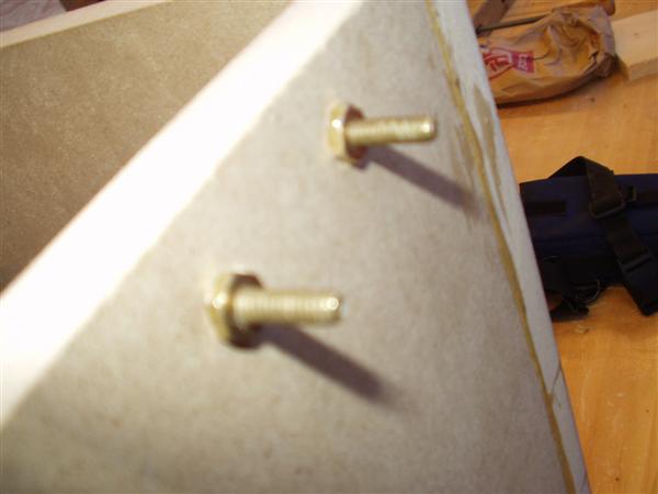

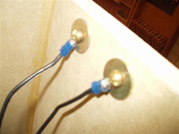

Oh yeah, I ended up saying F the t-nuts because I was having lots of trouble with the prongs bending and not having a router bit that would cut a big enough flange. I'm just going to glue a panel in there after I install some bolts for terminals.

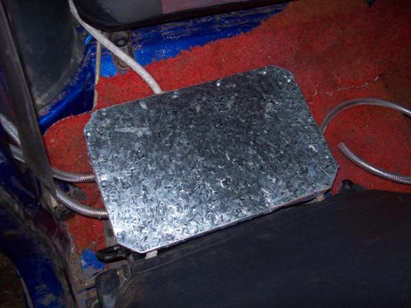

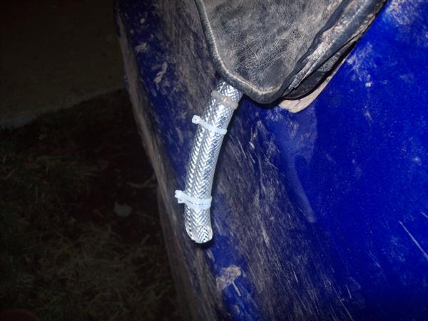

Big-a$s battery box:
^Those are the vents for the battery box.

You can see how I couldn't get enough space for the t-nuts. Stripped a machine screw so I had to use the hacksaw for cutting a slot in it.
