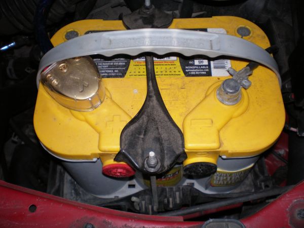

Silver Member Username: MarcoooPost Number: 432 Registered: Mar-07 | Hmm... I got a Optima Yellowtop under the hood with a dist block (0 AWG in, 4 AWG x 2 or 3 out) and a Kinetik all hooked up in the back. Let me know how many terminals you'd need and how much wire loom if you're up for it. I'm leaving late afternoon Friday and it's a 12-14 hour drive (lol) so I should be there at least 2 hours before it starts at noon. |

Gold Member Username: Nd4spd18Northwest PA Post Number: 6498 Registered: Jul-06 | A pic of your alt wire connection would be good also..... it's usually just a ring terminal but just to be sure. |

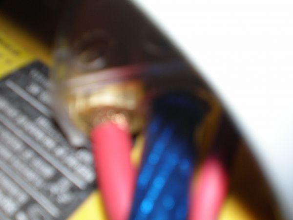

Silver Member Username: MarcoooPost Number: 440 Registered: Mar-07 | Here ya go MS, sorry about the quality, if ya need better let me know. If you need any other pictures let me know. I took pictures of all the wires under the hood since I don't really know what's what lol ![]() |

Gold Member Username: Nd4spd18Northwest PA Post Number: 6537 Registered: Jul-06 | OK, you're going to need a way to connect 1 more 0 gauge wire to the negative, and 1 more 0 gauge wire to negative for big 3. I recommend using battery clamps that give you posts, then you can use ring terminals on the wires...... this allows you to connect many wires to the terminal. Example: ^^^^^^^ Mine This is not the only way to do it, but it's the best way IMO. So for a big 3 and HO alt install you need: Wire Ring terminals. Remember to also get ring terminals for the other wires currently connected to the battery. Battery clamp adapters I have Phoenix Gold TMC-24G / TMC-25G. They work well. |
Silver Member Username: MarcoooPost Number: 444 Registered: Mar-07 | Alright thanks man I'll look up those PG adapters. How many ring terminals would I need, does it matter I have a battery in back? Sorry if I'm not much help, I don't know much about under the hood work. If I got adapters I could get rid of my dist block right? Don't really like the one I have now, can barely fit a wire with less than 4000 strands. That reminds me... Would I need new wire for 1500 watts, and eventually 3000 watts? My wire's kinda cheap and is most likely really 2 AWG. |
Gold Member Username: Nd4spd18Northwest PA Post Number: 6544 Registered: Jul-06 | You would need ring terminals for every wire thats to be connected to the battery. Get a few extra. Battery in the back is irrelevant here. 2 awg wire is fine for 1500w. For 3000w, 0 gauge. |
