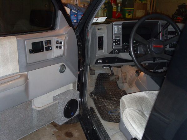

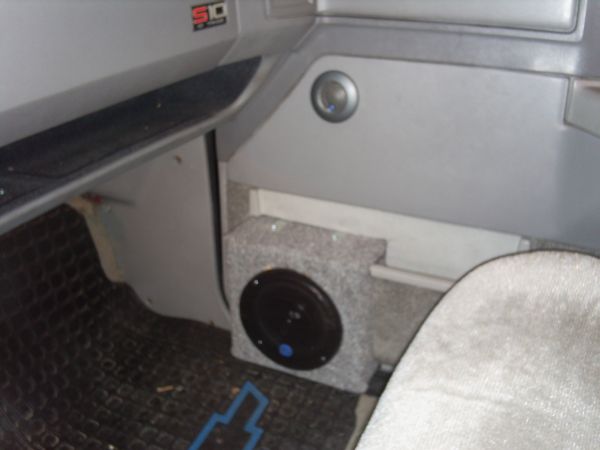

Gold Member Username: Nd4spd18Northwest PA Post Number: 6483 Registered: Jul-06 | It's damn near impossible to completely seal a door well......... even then, it would be way too much airspace for a little 5.25" or 6.5" speaker. A real enclosure designed for the speaker should make the difference. If you're lucky there may be enough space for it inside the door. If not, surface mount. For example: ^^^^^^^ Mine That is done completely from scratch BTW, the truck had no speakers in the doors to begin with. |

Gold Member Username: Nd4spd18Northwest PA Post Number: 6485 Registered: Jul-06 | Thanks Heres the entire system for anyone interested: https://www.ecoustics.com/electronics/forum/car-audio/430852.html |
