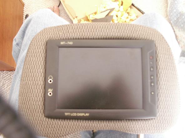

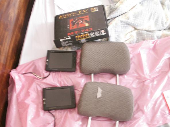

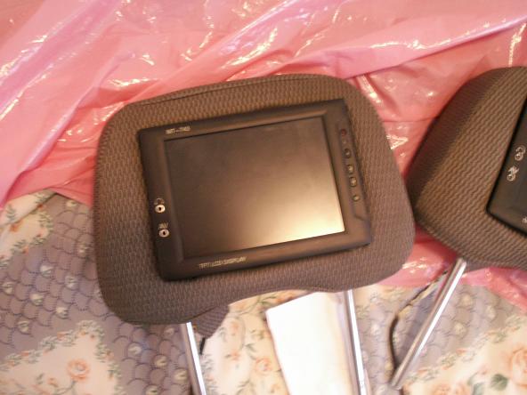

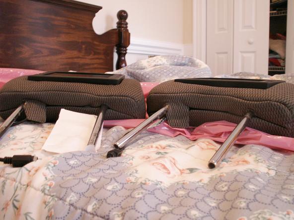

So I am installing the headrest monitors and here are some pics
2 Icon MT-743's

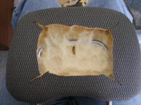

First you cut and X in your headrest monitors where you want the monitor to go. If you arent confident in yourself, don't try this. Its kinda nerve racking. Im glad I didnt fucc up on this one but I have one more to go.
Then dig out the foamI cut off the end of the X's to make some space behind the monitor on the inside to recess the monitor.
Here it is

thanks guys. Im using my IVA-W200 to play the DVDs. The only thing is one of the monitors didnt come with the trim ring which is also the thing that holds it in place so I will have to figure out a way to do that.

Yeah I agree w/ ya reece. I hate headrest monitors that arent in the headrest unless youve got em for kids or something.
My girl bought me the monitors b/c she knows Ive always wanted them and I found a deal WAY to good to pass up but Im out of a job.
Ive got the second one cut out now but Im tryin to figure out how Im going to get them to stay in the headrest. I should be finished tomorrow afternoon and Ill post some pics.

what about making a mounting bracket on the back of the unit , open the unit up pull the back plate off make some holes in the back plate drop a screw through the hole facing out and make it meet up with something inside the head rest. or do i the ghetto way, make a hole in the units back zip tie it to the metal bar in the headrest. as u pull tight it pulls the unit in then snip it when it's close tuck the excess behind the moniter. or lastly hit ebay for trim rings and do it right.
Username: Shortysetnies
Rock Vegas, NC US
Post Number: 2238
well the front screws to the back of the unit from the backside so I can't take it apart and put it back together. Im still trying to figure it out. Ebay doesn't have the mounting brackets so I think I will have to rig something up. Either way it WILL be clean. That I am certain of.

Hold them in the headrests using some good velcro and call it a day. It will work flawlessly.

damn nick. I feel retarded. Haha. Ill go pick some up this afternoon.
The install will take another day b/c it is raining hard here and I dont wanna work on it while it is raining. As long as it doesnt rain, they will be in tomorrow

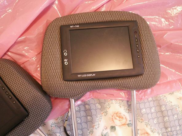

I'm A dumbazz. Im going to put the monitors in, in my garage. haha. Here are the pics of the progress so far.

Here it is guys

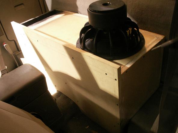

Yeah, it is extended cab and no, no one can sit in the back b/c my sub box takes up the back. I have them mainly b/c I have only seen one decent car with headrest monitors around here and I wanted to be different. Plus it is cool watchnig people behind you try and figure out what you are watching. Haha. When the insurance company pays me for a guy rear ending me Im getting my 6.5" rearview mirror monitor going again. Then come monitors in the visors (waitin for a job before I do that).

Here is how I held them in
I ended up having to put zip ties around the velcro on the headrest because it wasnt sticking to the padding in the headrest but it looks perfect when they are put in. Im really happy they are in and relieved I didnt fug up a headrest.

Haha, a lot of room...? Ever seen the back of one? Even gavin agrees that there is NO ROOM. The reason I wasnt worried about taking up the seats in the back is, no one would ride back there because there was no room. Even my girlfriend, 5'5" tall and 105lbs, was squished. I wish I had room.
I think that box is 15" deep and the seat touches it when I sit like normal.
