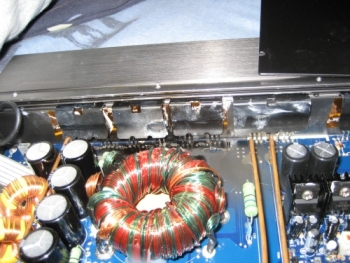

Silver Member Username: KaerfplSpencerport, NY USA Post Number: 830 Registered: Jun-06 | Eh, I went strait to opening up the amp and found that two small black things on the side of the amp are broken. What tey are, I have no idea but i'll post pics soon. |
Gold Member Username: Nd4spd18Northwest PA Post Number: 6448 Registered: Jul-06 | If they're on the side, off the board those would be FETs, one of the most common compoents to blow when an amp blows. Keep in mind, usually there is more damage than what you can actually see visually. |

Silver Member Username: KaerfplSpencerport, NY USA Post Number: 832 Registered: Jun-06 | ![]() |
Silver Member Username: KaerfplSpencerport, NY USA Post Number: 833 Registered: Jun-06 | ![]() |
Gold Member Username: Nd4spd18Northwest PA Post Number: 6508 Registered: Jul-06 | Like I said there is often more damage than can be seen.......... IDK how much you paid for the amp, but I wouldn't pay to get it fixed, I'd just buy a good quality amp. |
