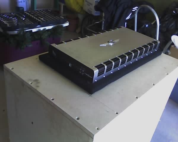

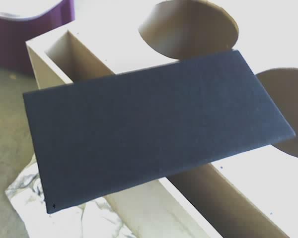

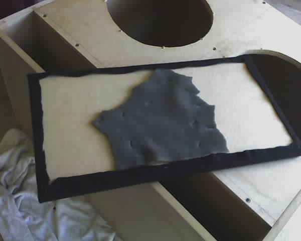

I want to double, maybe triple, baffle and pad under the amp so it's not rattling like crazy. I'm going with blue LEDs to shine through the plexi window that will sit between my back captains chairs and i'm going to probably do a battery rack on each side of the box for symmetry. Its going to be around 4.2 cubes after sub and port displacement tuned to 33 hz. I am debating on using aeros, going flared slot, or just regular slot.

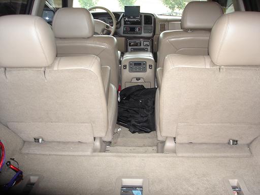

Also, here's a picture of the area it will be going into so you have an idea of what I mean.
Thoughts?

i wouldn't risk putting the amp on the box. or hook everything up and hold your hand on the layers of pad and if you feel any rattle on your hand at all (which i believe you will) don't mount it. looks sweet though

the side of the box isnt that big shouldnt rattle verymuch

I have my amp mounted on A second peice of MDF with foam between that peice and the box side... as well as carpet over the second peice...
No rattling...

yeah i was thinking of maybe doing something like that driz. i don't wanna do a rack because i want to have some room for other sh!t in the back of my car, and there's about 20 inches to the hatch. the amp is so fuggin big it's pretty incovenient.

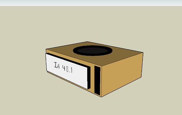

okay, so here's the final set on my box (i think). gonna go 20 h x 30w x 24d, sub and port up, port is 22.5 x 3 x 29.3 long. considering doing plexi on both sides now. do yall think i should just stick witht he plexi just facing the hatch or just facing between my captains chairs and leave the back of the both just carpeted.

should be badasssssss. pics of the design??
Username: Denali_on_22s
The kids love my rhyme...
Post Number: 4378
i havent got pics of the design exactly yet, but i was hoping to get some feedback on the design and if its a good one.
