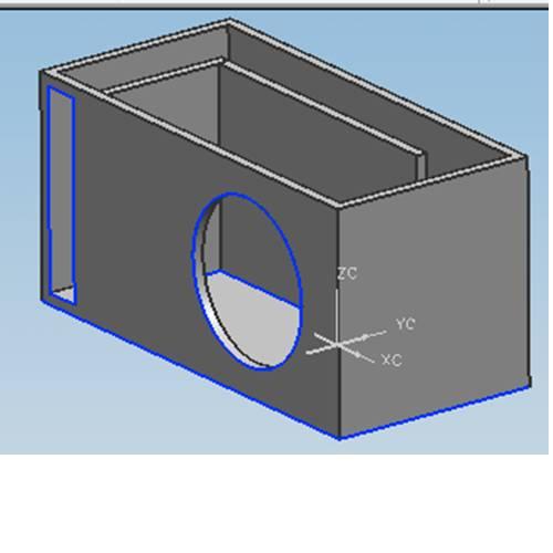

Bronze Member Username: DuckaShelby Township, MI United States Post Number: 52 Registered: Jan-08 | Im gunna be making the box out of 3/4" MDF probably no plexiglass unless I just do a window on it. Anyway I got a couple of pictures of plans. Let me know what you think. Its for a 12" alpine type-r. Ignore that the side walls are taller than the port, it looked weird when I made them the same size without a top with my program http://www.subwoofertools.com/forum/ported-box.asp?Ew=30&Eh=15&Dia=6&Xmax=18.2&Vd=.071&NumW=1&Vb=2&Fb=34&Qts=&Vas=&Fs=&CE=0 ![]() |

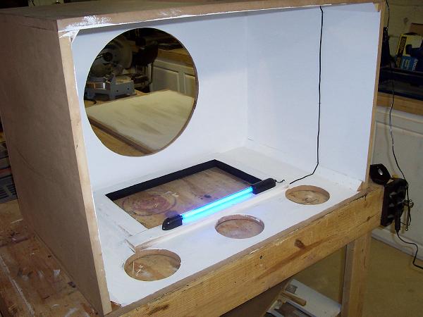

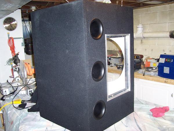

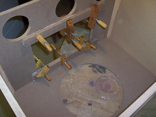

Platinum Member Username: WingmanaliveA pic is worth 1000 posts!! Post Number: 13984 Registered: Jun-06 | I had an inner channel of MDF that supported the window. Glued and screwed tight. The plexi laid flush with the outside of the box. Predrilled holes and screwed the plexi to the MDF channels, putting a bead of plexi adhesive down first. Then I locked the piece in with an aluminum channel. Pretty strong design. Tight as a drum. Threw some neon lighting in and bam! I can see everything I love lol.![]() |
Bronze Member Username: DuckaShelby Township, MI United States Post Number: 53 Registered: Jan-08 | That sounds pretty good. Thanks Paul. |
Platinum Member Username: WingmanaliveA pic is worth 1000 posts!! Post Number: 13986 Registered: Jun-06 | It's a little extra work but worth it. |

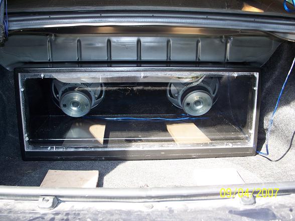

Silver Member Username: MesodummTri-City, Az Usa Post Number: 352 Registered: Apr-07 | If you need help I have I have built 6 or 7 full plexi boxes and several inlay's. You can cut the sheets but what I like best is to tape it up so you don't get deep scar's and use a sheet metal bender or box break, make sure you tape it also! It takes 3 or 4 guy's helping, 2 on bender and 2 with heat gun's. You end up with a much stronger box and only one seam to screw together other than the ends of course. |
Silver Member Username: MesodummTri-City, Az Usa Post Number: 353 Registered: Apr-07 | Nice box! ![]() |
Bronze Member Username: DuckaShelby Township, MI United States Post Number: 56 Registered: Jan-08 | thats sick |
