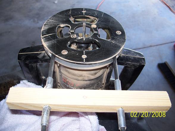

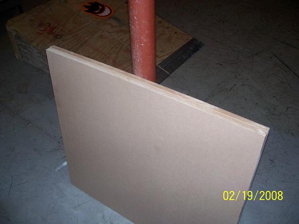

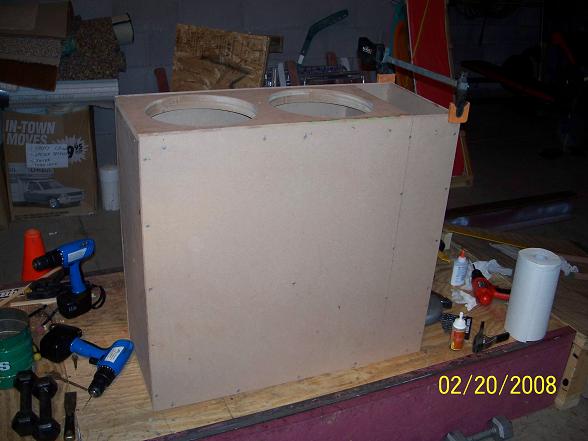

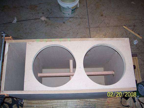

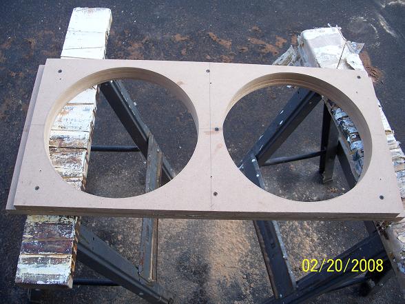

Gold Member Username: MendonmafiaUSA Post Number: 1251 Registered: Aug-06 | this is where i got tonight. its very cold out and i didnt feel like going back out to cut the circles with the router. so tommrow i shall do that and finish her up. Plans(inverted color showed up better) Terminal cups i am thinking of using 1.25" dowel for bracing Circle jig test all of the peices that fit between the top and bottom the top and bottom Progress as of tonight(front baffel is not connected yet just balanced) should be done with construction tommrow then i will mostlikely try to cover her with vinal. any tips or instructions on doing so? |

Gold Member Username: MendonmafiaUSA Post Number: 1263 Registered: Aug-06 | im actually done with the construction. i just gotta sand it, paint in the port and then cover it all up. ill post pics in a minuite |
Gold Member Username: MendonmafiaUSA Post Number: 1264 Registered: Aug-06 | Here they are. let me know what you think. Home made circle jig works awesome see what i mean 1.25" dowel braces port came up an 1/8" short but that only equates to 1.5 sqin small. i still got 61 inches of port SX's have a nice large home now! ![]() |

Gold Member Username: MendonmafiaUSA Post Number: 1266 Registered: Aug-06 | it weighs in at about a full sheet of mdf maybe slightly more. i am using an american bass xd 2000 for power. |
