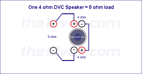

I am confused, according to 12 volt.com they say I can wire it two other ways. I attached the diagrams.Upload

You can. Each diagram illustrates a different way of connecting components in a circuit.
In the first diagram, you are wiring the voice coils in parallel, which gives you a 2 ohm impedance. This is due to there being 2 paths for the electrons, therefore less impedance.
In the second one, the coils are wired in series. Because the electrons have to travel through both 4 ohm coils before the can complete the circuit, the impedances are added. This gives you an 8 ohm load.
Remember the terms "parallel" and "series".
Series: add resistances.
Parallel: Divide 1 by each load (unit = ohms) then add your answers to get the final load (of course, this omits resistance from your conductors, terminal, etc.). Example using yours: 1/4 + 1/4 = 1/2 (the reciprocal will be your load). I didn't explain that well but the example should make it obvious. Now, when it comes to speakers, we usually deal with equal loads, so you can usually just divide the IDENTICAL load by the number of components. Example: two 4 ohm voice coils = 4/2, which equals 2.
