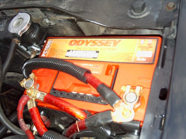

Gold Member Username: Nd4spd18Northwest PA Post Number: 6358 Registered: Jul-06 | You will find a way to make everything fit...... how many wires can you have........ Heres mine with dual terminals: The factory wiring is on the side terminals. On the top terminals there are: power wire for component amp, power and ground wires for sub amp, and + and - big 3 wires. |
Silver Member Username: WaresgaragestereoFort Valley, GA United States Post Number: 145 Registered: Jan-08 | if you want it bad enough you'll find a way to make it fit. sorry i'm being so harsh about it. you probably could just modify the batt tray to accept a larger size. M.S, Nice work man. what you use to crimp those terminals on the 1/0 wire? the hammer trick don't work to good. they pull off when you crimp with the hammer. so i guess i'll crimp 'em and solder too. but nice work on the batt. |
Gold Member Username: Nd4spd18Northwest PA Post Number: 6365 Registered: Jul-06 | Ware, See my post in this thread: https://www.ecoustics.com/electronics/forum/car-audio/438861.html |
Gold Member Username: Th3pwn3rPost Number:... Post Number: 6962 Registered: Jul-06 | "M.S, Nice work man. what you use to crimp those terminals on the 1/0 wire? the hammer trick don't work to good. they pull off when you crimp with the hammer. so i guess i'll crimp 'em and solder too. but nice work on the batt." Lol, you need to drink more milk if you can't hammer a terminal on. The only problem is then you have a very WIDE and flat terminal. Try using a metal block or plate under the wire and terminal before you hammer it. |
Silver Member Username: WaresgaragestereoFort Valley, GA United States Post Number: 146 Registered: Jan-08 | i went to Napa and bought a crimper like M.S posted on the other thread. |
