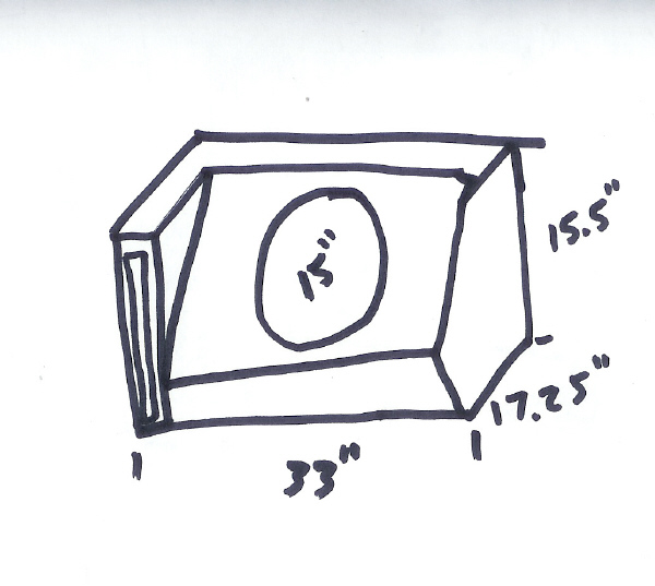

Silver Member Username: 2000celicaRoanoke, VA U.s. Post Number: 111 Registered: Jan-08 | here is an idea i had for a ported box for one 15 Q. the highest i want to go in my trunk is 15.5 inches total so in order to fit a 15 i could do a slanted box. secondly i want to go ported to make the sub louder overall. i've also heard that non-square boxes are better than square ones so with all of that i came up with this idea: the box will roughly by the dimensions listed on the pic. as you can see it will be a slanted, hatch back type box along with a normal standard type port. does anyone like this idea, think it's a bad idea, have any advice on a different type box i could make or ways to make this box better? this is just a very rough free hand sketch of the box. i wanted to get some input on it before i go to the trouble of drawing everything to scale and getting the exact ft^3. |
Gold Member Username: Denali_on_22sThe kids like my rhyme... Post Number: 4205 Registered: Feb-06 | i would say it's a faily bad idea... if you are going to do something like that go with aeroports out the side or something... |
Silver Member Username: 2000celicaRoanoke, VA U.s. Post Number: 113 Registered: Jan-08 | any advice on how to make such ports? plan on tuning to 30 Hz. port will need to be rather long. |
Platinum Member Username: Rovin4 10 Pioneer... Post Number: 13131 Registered: Jul-05 | looks like plenty carpentry what u can also do is build a slant faced box & just do a square or rectangle port on a side of the box ... |

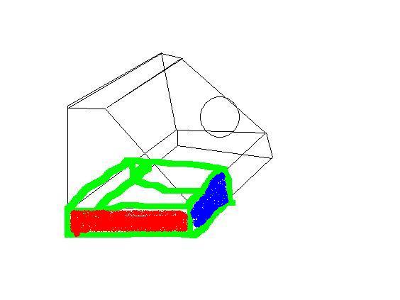

Silver Member Username: Surferdude9371Im BTL Bumpin Post Number: 655 Registered: Mar-07 | this is what i was gonna do coming out the red rectangle but gettin mixed feedback on it |
Platinum Member Username: Rovin4 10 Pioneer... Post Number: 13135 Registered: Jul-05 | was just looking at a Q's specs & they say its Sub OD: 15.625" so thats basically 18" taller than 15.5" - cant u just squeeze in that lil 1\8 instead & just make a noramle rectangle shaped box .... |
Platinum Member Username: Rovin4 10 Pioneer... Post Number: 13136 Registered: Jul-05 | '''''''so thats basically 18" taller'''''' - typo ...meant 1\8" ...... |
Silver Member Username: SomedonniedudeIllinois United States Post Number: 968 Registered: May-07 | "i've also heard that non-square boxes are better than square ones" Not exactly. Check out this link. And if you do stick with your original idea above, I would say areo ports imo. http://www.teamtoxicbass.com/literature/writeups/the_golden_ratio/index.htm |
Gold Member Username: ShortysetniesRock Vegas, NC US Post Number: 2120 Registered: Mar-06 | Im not a great box builder but why wouldnt it work? If it has the needed air space and everything I would think it would. Not advising it b/c I dont know that it would or not, just looking for someone up there ^ to give a reason for saying no |
Silver Member Username: 2000celicaRoanoke, VA U.s. Post Number: 114 Registered: Jan-08 | i think i may go with a sqaure type port along the back wall at the bottom, if the port size would work and was able to fit correctly. i could make a sqaure box, which would be easier, but i just think popping my hatch and seeing a 15 pointed right at you at 45 degrees would like nice. |
