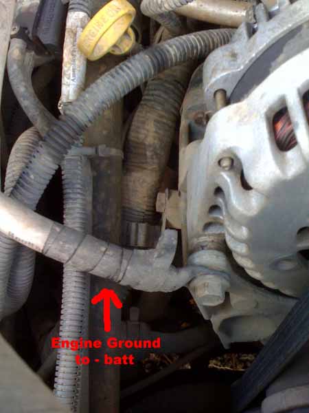

Gold Member Username: Snarl2004Digital Design 9515, Massive Audi... Post Number: 2158 Registered: Dec-06 | it isnt an existing wire. find any bolt that goes into your engine block and put a wire there and put the other end of the wire either to - batt or some bar metal on the frame of the vehical. As for the wire i would do 2 lengths of 4awg that way its the equivilant of the stock wire plus a 1/0 wire. for my engine ground i put a wire where i securedd the alt to the engine becuase it was right on the block then the other end to - batt |
Gold Member Username: Snarl2004Digital Design 9515, Massive Audi... Post Number: 2159 Registered: Dec-06 | hope this clears some things up ![]() |

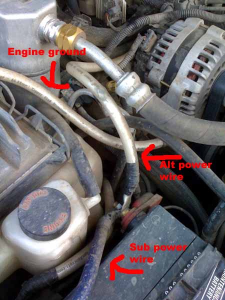

Silver Member Username: EvoixmrPost Number: 138 Registered: Aug-07 | thanks, snarl. Any ideas for adaptors to hook up that much 0gauge to my battery. pic of my battery. the grey 0 gauge goes to the amp and the red 4gauge goes to the alt. [IMG]http://i273.photobucket.com/albums/jj236/evoIX719/final044.jpg[/IMG] |
Silver Member Username: EvoixmrPost Number: 139 Registered: Aug-07 | do you ground engine to chassis or engine to battery? |
Gold Member Username: Snarl2004Digital Design 9515, Massive Audi... Post Number: 2161 Registered: Dec-06 | dunno about how to hook it up to the battery i guess use your imagination there lol well your battery is grounded to chassis so you can ground engine to - battery or chassis which ever you want. |
